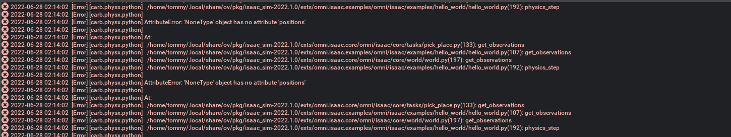

The error content in the video above.
[Error] [carb.physx.python] AttributeError: ‘NoneType’ object has no attribute ‘positions’
If I load using Hello World extension of Isaac Exams where I put my robot in, there will be no error, but if I stop and press Play again, there will be an error above.
However, if I use the Reset button in Hello World extension without pressing play, the error will come out, but the robot will move.
The really hard part for me is why my robot can’t go forward, as shown in two videos.
There is also a problem of my lack of knowledge, but I don’t know which part to modify.
I would like to ask an additional question.
Is there any way to know wheel_radius and base on my customized robot in Omniverse?
Right. That error happens at every time step and floods the console, and is likely due to some other error that caused the initialization of the Pick and Place task to halt and not get created. (hence nonetype). I’d need the stack from the very first error if possible. You can do it from the terminal that opens with Isaac sim.

2022-06-28 05:24:36 [228,030ms] [Warning] [omni.isaac.core.articulations.articulation_view] Physics Simulation View is not created yet in order to use get_joints_state
2022-06-28 05:24:36 [228,030ms] [Error] [carb.physx.python] AttributeError: 'NoneType' object has no attribute 'positions'
At:
  /home/tommy/.local/share/ov/pkg/isaac_sim-2022.1.0/exts/omni.isaac.core/omni/isaac/core/tasks/pick_place.py(133): get_observations
  /home/tommy/.local/share/ov/pkg/isaac_sim-2022.1.0/exts/omni.isaac.examples/omni/isaac/examples/hello_world/hello_world.py(107): get_observations
  /home/tommy/.local/share/ov/pkg/isaac_sim-2022.1.0/exts/omni.isaac.core/omni/isaac/core/world/world.py(197): get_observations
  /home/tommy/.local/share/ov/pkg/isaac_sim-2022.1.0/exts/omni.isaac.examples/omni/isaac/examples/hello_world/hello_world.py(192): physics_step

Regarding your error, it seems it’s happening on this file :
File "/home/tommy/.local/share/ov/pkg/isaac_sim-2022.1.0/exts/omni.isaac.examples/omni/isaac/examples/hello_world/hello_world.py", line 68, in set_up_scene.
It’s really hard to repro your issue without having the same assets as you have, but a few things to look out are:
  1. Making sure the files and paths to references you are adding exist and are valid.
  2. making sure the prims you are referring when creating the Tasks and Robots exists and are not empty
You can add print commands in between lines to find the specific line where it crashes, but it seems like it’s crashing on set_up_scene, most likely due to self._pick_place_task being None (failed to initialize)
