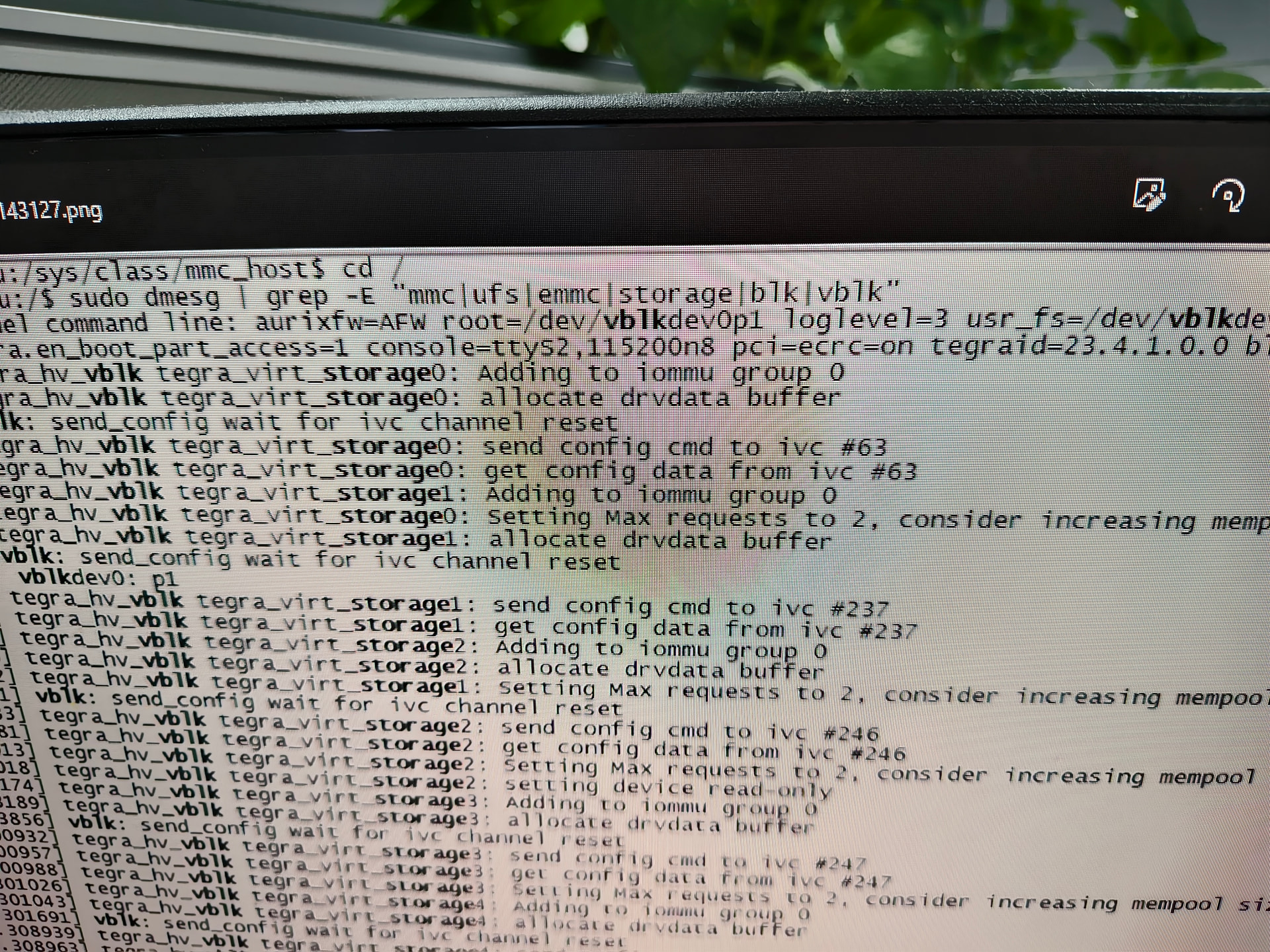

AGX Driver Orin: How to get the emmc/UFS device's information?
We can’t get the emmc/UFS device’s information. We find a devices named /dev/vblkdev2 ,May it be UFS? but we cannot edit it.

Hi evelyn.xie,
Please share the log as text file instead of the screenshot.
You can simply run lsblk to check the current device.
Hi Kevin:
I am using the AGX Orin development kit, Here is the log file.Please help me identify which one is the emmc partition and which one is the ufs partition. I would like to run FIO or DD tests on these two partitions,thank you.

[2026-01-14 16:13:46]           Starting DRIVE OS LINUX Board specific initialization...
[2026-01-14 16:15:51]  Filesystem      Size  Used Avail Use% Mounted on
[2026-01-14 16:15:51]  /dev/vblkdev0    26G  6.2G   19G  26% /
Are you using DriveOS rather than L4T?
How did you flash AGX Orin devkit?
I am using DriveOS, which was obtained from this path.
This development kit also came with this system when it was delivered to us from the factory. Can this system not perform tests on eMMC or UFS?

Dear @evelyn.xie ,
vdevblk0 is eMMC and vblkdev2 is UFS.
