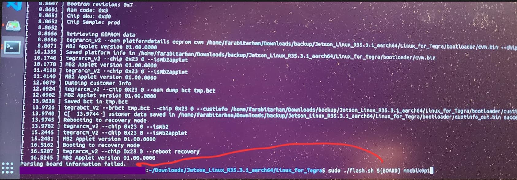

AGX Orin 64GB Not Booting – “Hypervisor is not present” and “Parsing Board Information Failed” Errors
We have several NVIDIA AGX Orin 64GB modules. One of the devices entered a state where it fails to boot after a reboot.
As shown in the attached console screenshot, the system ends up on a black screen with the message:
“hypervisor is not present”.
We tried to reflash the device using NVIDIA SDK Manager, just as we successfully did with the other two devices. Due to the following errors it didn`t end up successfully.
We also tried the flash.sh script. However, this time we encountered the following error during the process:
“Parsing Board Information Failed”. It is working for the the other ORIN AGX we have successfully.
Upon investigation, we suspect this might be related to EEPROM corruption or misconfiguration. Unfortunately, since the device cannot boot, updating the EEPROM does not seem possible from our side.
Could you please help us resolve this issue or guide us on how to proceed?

Please try to get the real useful information first.
We don’t use such screenshot to tell information. There is a export logs button on your sdkmanager GUI. Click after your flash failure and attach the zip file.

Your EEPROM content is corrupted.
17:11:42.907 - Info: — Parsing board ID (ERROR: calculated CRC8 0xb7 != stored CRC8 0xb) succeeded.
17:11:42.910 - Info: — Parsing board version (ERROR: calculated CRC8 0xb7 != stored CRC8 0xb) succeeded.
17:11:42.913 - Info: — Parsing board SKU (ERROR: calculated CRC8 0xb7 != stored CRC8 0xb) succeeded.
17:11:42.916 - Info: — Parsing board REV (ERROR: calculated CRC8 0xb7 != stored CRC8 0xb) succeeded.
