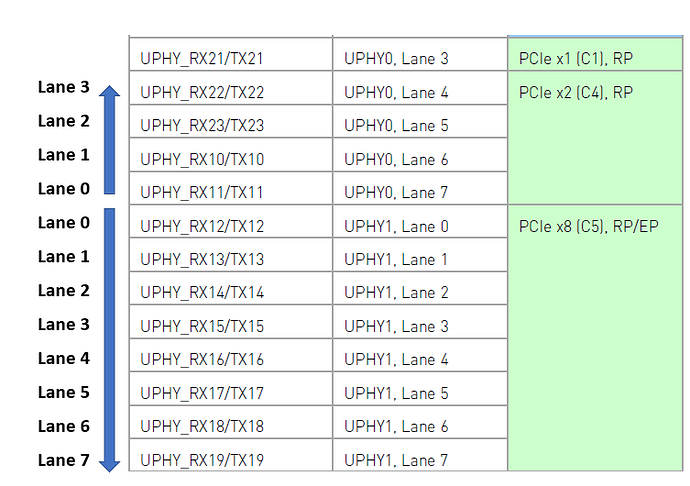

We are planning to use Configuration #1, For PCIe Port C4, is it x2 lane or x4 lane? In this which is Lane 0, 1, 2, 3? Looks like UHPY RX/TX22 should be Lane 0 and UPHY RX/TX11 is lane 3 but its connected otherwise in Development kit? Where can I get this info to be confident.
Since the development kit uses Configuration #1, is only x2 lane supported for M.2 E key? and other connections are for future upgrade?
Same question for PCIe port C5, which is Lane 0 and Lane 7?
Based on the Jetson AGX Orin UPHY Mapping Options query, you have mentioned it as Typo for C5 x4 lane for configuration #3. Is it typo as well for C4 x2 for configuration #1?
Hi, it is x4 for C4. The Lane number is listed in turn (UPHY22 is Lane0 and so on). C1 (x1) is for M.2 E on devkit. Same number in turn for C5 (UPHY1 Lane0 to 7).

In the P3737_A04_OrCAD_schematics.pdf, for C4 and C5 the lane mapping does not match what is provided in Design guide. Could you please let me know which is correct?
