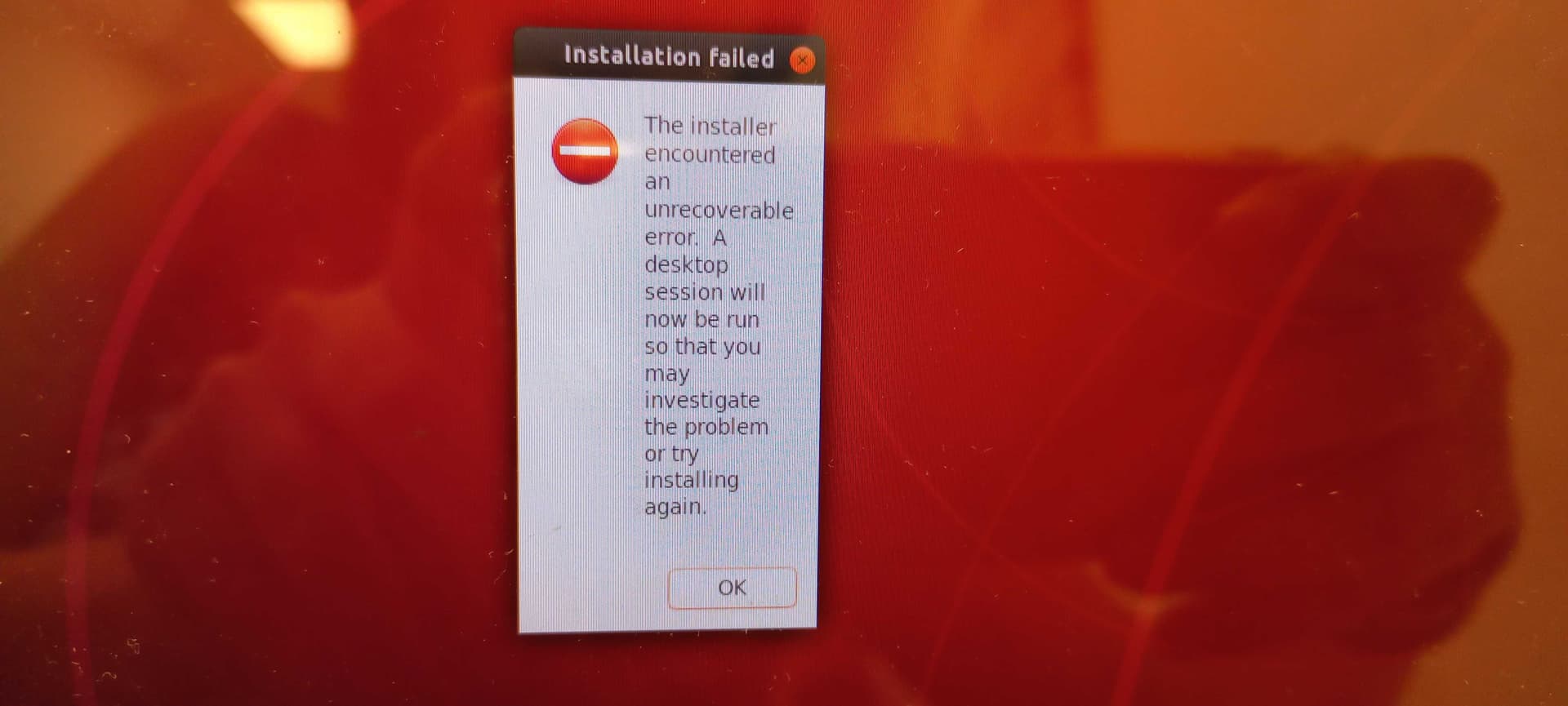

Dear Sir or Madame,
I am installing Jetpack 4.6.1 on my Jetson nano 2GB from this link JetPack SDK | NVIDIA Developer.
I am getting the following error:
If I install Jetpack 4.6 on my Jetson nano 2GB, there’s no deepstream version compatibility with Tensorrt 8.0.1.
So please how can I fix the issue of Jetpack 4.6.1? Or which version of deepstream is compatible with tensorrt 8.0.1?
Yep, same problem for me. Sam screen from first attempt. Have re-tried img etching. No work.
We tried to use the same image on the page you shared. But we are still able to boot without error.
Please make sure you are using the correct image file. For example, 4GB image cannot be used on 2gb device.

Exactly. There’s something wrong in the image itself
Just want to double confirm. Is this your first time flashing any kind of sdcard image on your nano 2gb?
I mean are you a newbie for all of these or you already tried some early jetpack release before?
No this is not my first time flashing sd card images on nano 2gb. I have tried with Jetpack 4.6, it works fine. I tried with Jetpack 4.4 and it works fine.

Please dump the serial console log when the error happened.
Also want to ask,
  1. What is the Balena Etcher version you people are using?
  2. Did you ever flash your board with sdkmanager before?

Apparently the image was corrupt or something like that even though I downloaded it twice.
I downloaded the image again and it is working fine so far. Maybe there was an update on the image itself.
Thank you for your help.
Hi @melissa1 . Thank you so much for this post! Because of your post, I was able to finally get the nano booted. I think you are right in that the Jetpack 4.6.1 has some corrupt file. I’ve tried every suggestion out there until I saw your post. I went and reformatted and etched the sd card again with the Jetpack 4.6 version and it finally boots now. For other people struggling, here is where I downloaded the older version from: https://developer.nvidia.com/jetpack-sdk-46

I got the same exact problem, using new jetson nano 2gb and new sd card 32gb, Here is the log:

  File "/usr/sbin/l4t_payload_updater_t210", line 1366, in <module>
    main(param)
  File "/usr/sbin/l4t_payload_updater_t210", line 1351, in main
    print_VER(arg)
  File "/usr/sbin/l4t_payload_updater_t210", line 57, in print_VER
    system_info_obj.print_current_ver()
  File "/usr/sbin/l4t_payload_updater_t210", line 527, in print_current_ver
    if ver[0] == 'NV1' or 'NV' not in ver[0]:
IndexError: list index out of range

subprocess.CalledProcessError: Command '['/usr/lib/nvidia/qspi-update/nvqspi-update.sh', '-c']' returned non-zero exit status 1.

I have installed Version 4.4 and it works fine, Thank you.
Turns out the log of oem-config.log is also not sufficient.
If possible, for anyone hit this issue, please directly share the uart log.
