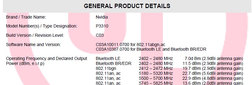

You can find the CE doc in package: http://developer.nvidia.com/embedded/dlc/Jetson-TX2-Compliance-Docs

Since from the compliance document, TX2 is already have CE certification, NVIDIA should have experience for the BT test?
Hi seeway.ho,
The guidance for BT is the same as WiFI. Customer can’t change any parameters and need to use our certification, see https://developer.nvidia.com/jetson-tx1-and-tx2-oem-wireless-compliance-guide
Those docs are valid for BT as well. Our compliance guide also covers 802.15 (Bluetooth)
