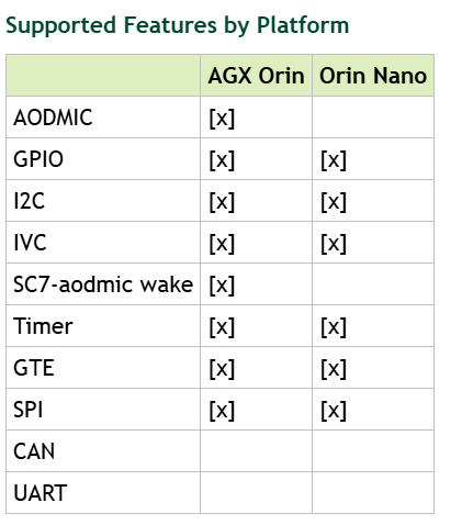

Can you refer to Controller Area Network (CAN) — NVIDIA Jetson Linux Developer Guide and use internal mttcan instead?
It seems they are also from AON cluster. (PAA.00/PAA.01).
In the following table of current SPE document, it seems we don’t support for using CAN through SPE firmware.
As the thread you linked, maybe you have to implement them manually.
Yes. This is what I’ trying to do, but the Technical Reference Manual does not document how to setup the clocks as the CAR block is not documented.
I was hoping to get the support mentioned by Jachen from the referenced thread.
Hi andreas6,
I’ve found the following document from old release with CAN support in SPE.
Jetson Sensor Processing Engine (SPE) Developer Guide: CAN Application (app/can-app.c)
It seems we’ve removed it in current release for Orin series.
You can try to implement it manually but we don’t support for this use case and have not verified it on Orin currently.
Hello, andreas6:
yes, as Kevin stated, the CAN in Orin SPE is not supported so far.
Anyway, I think it’s still possible to implement that by yourself.
CAN-SPE can work in old BSP/SOC (rel-32/Xavier/Parker). You can take that code as reference.
If you get any problem, feel free to paste the code clip and logs here, and we can provide some suggestions.
Generally, you can do that step by step.
  1. Make sure that the SPE can access corresponding CAN module registers correctly. (Note, only CAN in AON cluster is accessible.)
  2. Inter-connect with CAN transceiver to do a test.
  3. Check waveforms for data transfer/clock setting.
Hope that can work in your side.
br
ChenJian
