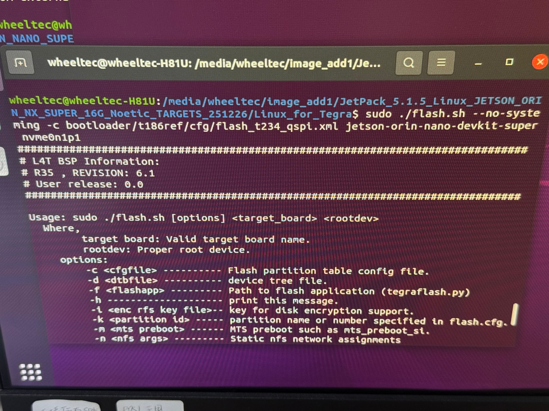

Hi @MaxineZ,
For JetPack 5.1.5 / Jetson Linux R35.x, bootloader/t186ref/cfg/flash_t234_qspi.xml is the expected path. The bootloader/generic/... path is used in newer JetPack 6 / R36.x packages, so you do not need to replace t186ref with generic for your current package.
Please make sure the command includes both <board> and <rootdev>. The QSPI-only command pattern for R35.x is:
sudo ./flash.sh --no-systemimg -c bootloader/t186ref/cfg/flash_t234_qspi.xml <board> <rootdev>
For example, if your board config is jetson-orin-nano-devkit-super and your root filesystem is on the first NVMe APP partition, the command would be:
sudo ./flash.sh --no-systemimg -c bootloader/t186ref/cfg/flash_t234_qspi.xml jetson-orin-nano-devkit-super nvme0n1p1
Please also confirm the available board config files in your Linux_for_Tegra directory:
ls jetson-orin-nano-devkit*.conf
Use the board name that matches an existing .conf file, without the .conf suffix.
Recommendation:
Do not use the NVMe/external-storage flash flow if your goal is only to update/recover QSPI and keep the NVMe rootfs unchanged. If the command still reports Invalid target board, please share the exact command you typed as text and the output of the ls jetson-orin-nano-devkit*.conf command above.

I feel confused that I just want to flash module but not nvme,so rootdev is optional or neccessary?If I fill rootdev with nvme0n1p1,may anything in nvme be covered?
Hi @MaxineZ,
Yes, <rootdev> is necessary for flash.sh. The command format requires both <board> and <rootdev>:
In this QSPI-only command, <rootdev> tells the script where the existing root filesystem is expected to be. It is not the same as using the NVMe flash flow.
So if your current root filesystem is on the first NVMe APP partition, using nvme0n1p1 as <rootdev> is OK in this command:
With --no-systemimg and flash_t234_qspi.xml, this is for flashing QSPI only and should not reflash or repartition the NVMe rootfs/APP partition.
Recommendation:
Do not add NVMe/external-storage flashing options such as --external-device, --external-only, flash_l4t_external.xml, or flash_l4t_t234_nvme.xml unless your purpose is to flash or repartition the NVMe SSD.
If your root filesystem is not on nvme0n1p1, please replace it with the correct root filesystem device/location for your setup.
