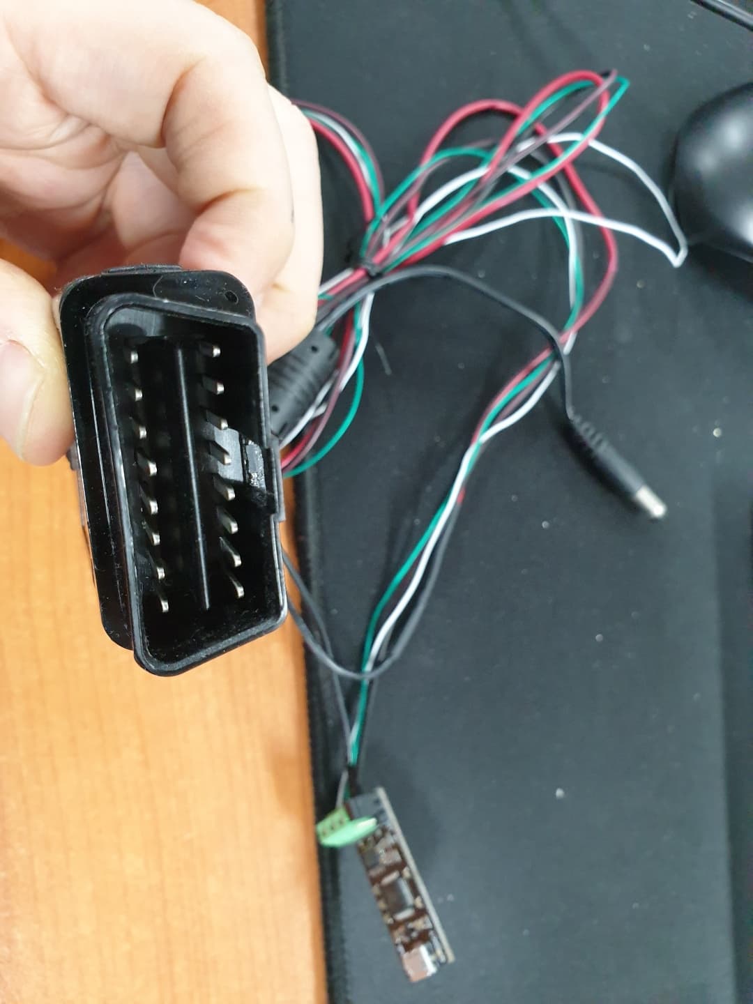

Hello, @kayccc , @Trumany
What should I do if I use a usb2can device as follows?

Looking at the post from @forumuser - their USB-CAN interfaces are marked as being “cando” - looking at their website, they appear to have not bothered writing a proper socketcan driver for Linux, and instead offer some sort of proprietary SDK - CANdo - Simple USB to CAN Bus API
Such hardware might not play nice with a Jetson since their binary SDK is probably x86 only. Other USB-CAN converters (such as the CANable I mention, anything supported by the candlelight project at GitHub - candle-usb/candleLight_fw: gs_usb compatible firmware for candleLight, cantact and canable, EMS CPC-USB converters from USB/CAN Interface CPC-USB/ARM7 - EMS Dr. Thomas Wünsche, and a few others work with socketcan. I believe PCAN adapters will work too, but I haven’t personally used them.
