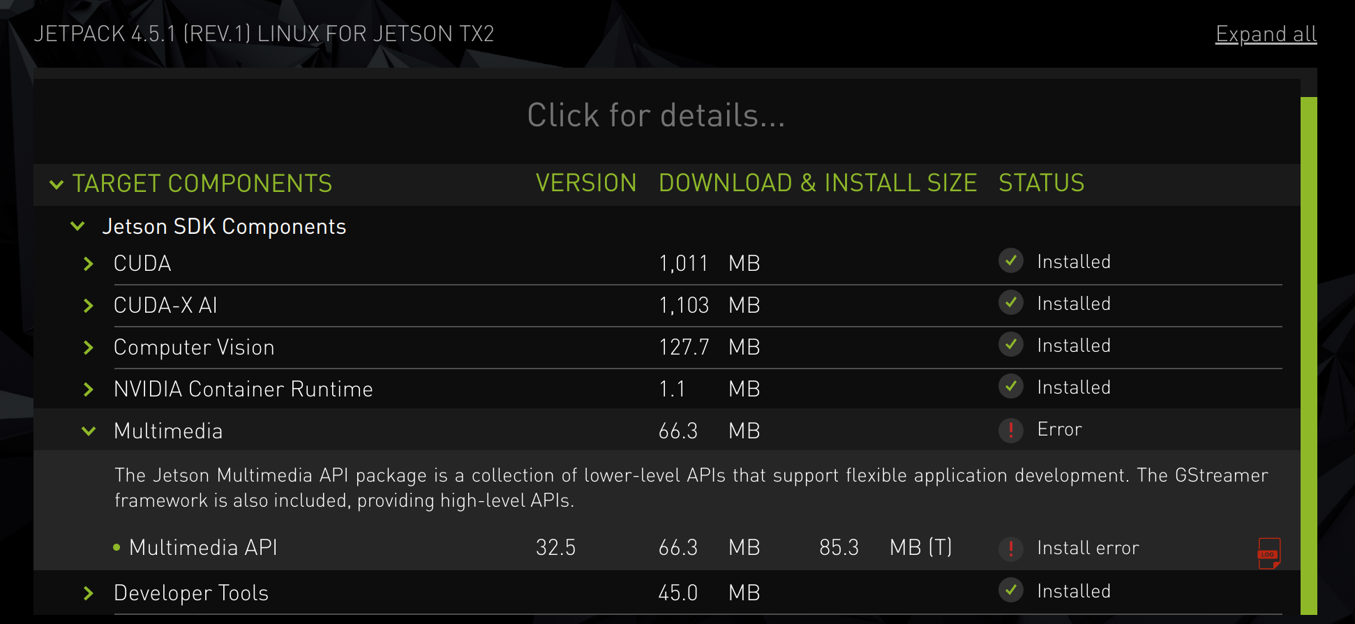

Can not install jetpack 4.5.1 by sdk manager
11:20:00 INFO: Multimedia API - target: Note, selecting ‘nvidia-l4t-jetson-multimedia-api’ instead of ‘/opt/nvidia/deb_repos/nvidia-l4t-jetson-multimedia-api_32.5.1-20210219084708_arm64.deb’
11:20:00 INFO: Multimedia API - target: The following packages have unmet dependencies:
11:20:00 INFO: Multimedia API - target: Depends: nvidia-l4t-multimedia-utils (= 32.5.1-20210219084708) but 32.5.2-20210709090156 is to be installed
11:20:00 ERROR: Multimedia API - target: command terminated with error
11:20:00 SUMMARY: Multimedia API - target: APT system is broken and requires manual fix
11:20:00 SUMMARY: NVIDIA Nsight Systems - target: Install completed successfully.
Please try to install it through apt install:
$ sudo apt install nvidia-l4t-jetson-multimedia-api=32.5.1-20210219084526
E: Version ‘32.5.1-20210219084526’ for ‘nvidia-l4t-jetson-multimedia-api’ was not found
can’t find the version.
Hi hpf9017,
We can’t reproduce your issue when install JP-4.5.1 on TX2.
Please try install again via SDKM or use below steps to install MMAPI packages by manually:
$ sudo apt update
$ sudo apt list -a nvidia-l4t-jetson-multimedia-api
nvidia-l4t-jetson-multimedia-api/stable 32.5.2-20210709090156 arm64 [upgradable from: 32.5.1-20210219084708]
nvidia-l4t-jetson-multimedia-api/stable 32.5.1-20210519111140 arm64
nvidia-l4t-jetson-multimedia-api/stable 32.5.1-20210505093723 arm64
nvidia-l4t-jetson-multimedia-api/stable,now 32.5.1-20210219084708 arm64 [installed,upgradable to: 32.5.2-20210709090156]
nvidia-l4t-jetson-multimedia-api/stable 32.5.0-20210115151051 arm64
$ sudo apt install nvidia-l4t-jetson-multimedia-api=32.5.1-20210219084708
