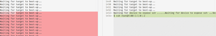

Can’t backup OEM AGX Orin board. Waiting for target to boot-up
backup.txt (107.1 KB)
I have set cvb_eeprom_read_size = <0x0>; in bootloader/tegra234-mb2-bct-common.dtsi.
I have created the OEM config named nd004a.conf, then I run the commond:
sudo ./tools/backup_restore/l4t_backup_restore.sh -b nd004a
When I backup, console always output waiting for target to boot-up…
My sdk version is jetpack r36.4.3
Best regards,
Jacobe Zang

HI,
Please record the serial console log for us to review.
device_log.txt (65.8 KB)
Okay
Some questions to confirm:
Have you used this OEM config to flash the AGX Orin Successfully?
Yes.
I use the following command:
sudo ./flash.sh nd004a internal
Please try below commands
sudo ./tools/backup_restore/l4t_backup_restore.sh -e mmcblk0p1 -b nd004a
The same error. I post the console log.

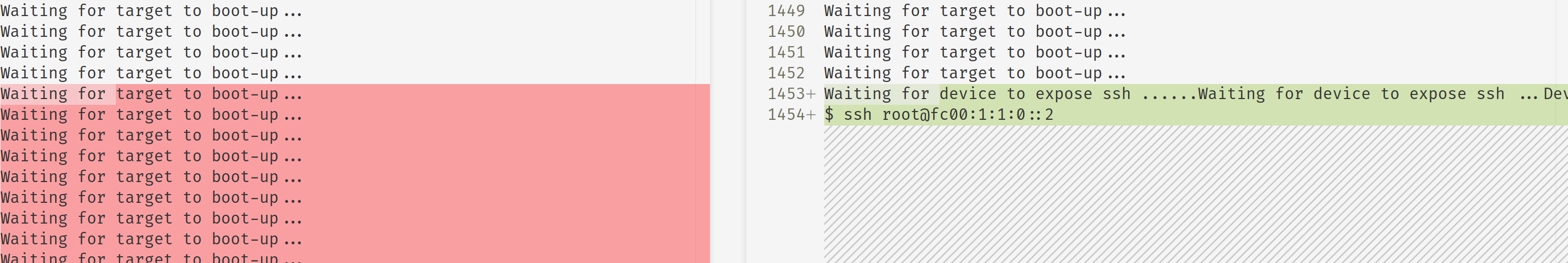

I also test the jetson-agx-orin-devkit to backup and contrast them. I found that devkit has the ssh. May I lost something like usb net in my OEM configuration?
console_log.txt (65.7 KB)
No known UDC device found
We see your log show similar issue discussed in
Please confirm your device tree could enable usb device mode.
I followed the developer guide to config USB, but seemed still no UDC. Could you help me check is there something I forget to config?
nd004a_dtc.txt (326.2 KB)

Now my dts config as followings:
				usb2-0 {
					mode = "otg";
					usb-role-switch;
					status = "okay";
					role-switch-default-mode = "host";
Works good for me.
