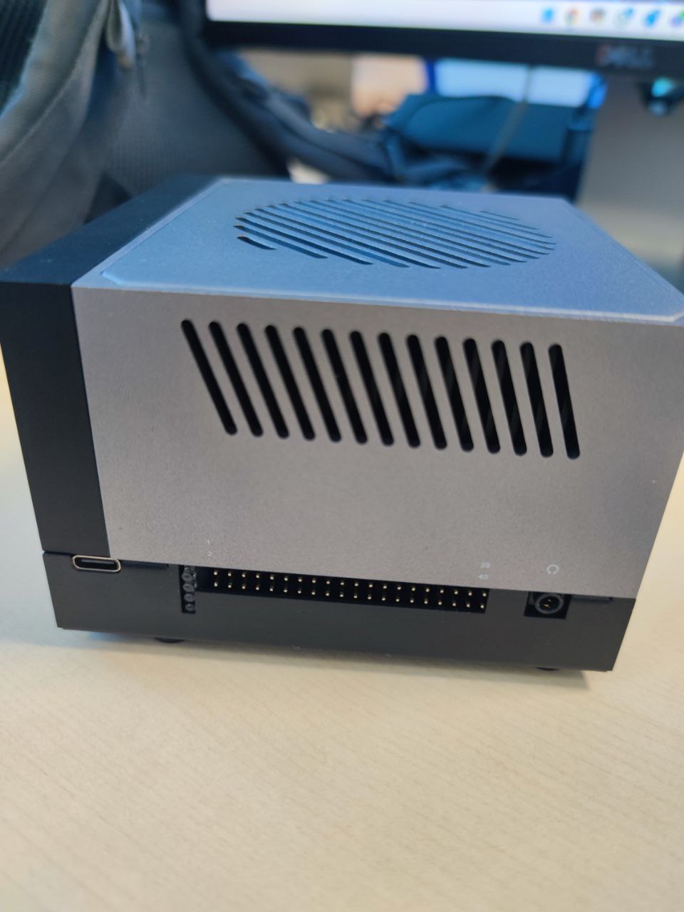

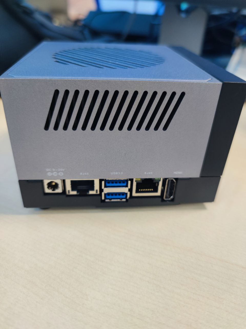

Do you use the micro-USB cable to connect mentioned port?
If yes, try to change to other micro-USB cable support data transfer.
Hi, no don’t have a micro usb Port, only USB-C port
One question to confirm:
  • Is your AGX Orin using a dev kit or a custom carrier board?
Based on your description, it might be custom carrier board.
SEED STUDIO? BOARD?,
HI,
Yes. It’s a custom carrier board.
Please reach out the seeed studio to get the customized bsp.
