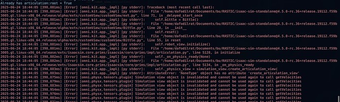

I am trying to create an extension that will allow me to configure reinforcement learning parameters in isaac sim. I am making use of the stable baselines 3 model to train a model. Isaac sim environment is wrapped withing a custom gym environment to support stable baseline 3. When I run this setup via python.sh everything works but when running it via extension, I am unable to create an articulation view because the api is not able to find the physics context.

Here is the Bittle class that is causing the issue :
from isaacsim import SimulationApp
simulation_app = SimulationApp({“headless”: False}) # start the simulation app, with GUI open
from isaacsim.core.api import SimulationContext
from isaacsim.core.utils.prims import is_prim_path_valid, get_prim_at_path
from isaacsim.core.prims import Articulation
from isaacsim.core.api import World
from isaacsim.sensors.physics import _sensor
from isaacsim.core.simulation_manager import IsaacEvents, SimulationManager
from omni.isaac.core.utils.stage import open_stage
open_stage(“/home/dafodilrat/Documents/bu/RASTIC/rl_world.usd”)
from pxr import UsdGeom, Sdf
from scipy.spatial.transform import Rotation as R
import time
import numpy as np
from omni.isaac.core.utils.stage import is_stage_loading
import omni.physics.tensors as tensors
class Bittle():
def __init__(self):
    self.robot_prim = "/World/bittle"
    self.world = World(stage_units_in_meters=1.0)
    self.wait_for_prim(self.robot_prim)
    self.wait_for_prim("/World/PhysicsScene")
    self.reset()
def reset(self):
    # Wait for prims
    prim = get_prim_at_path(self.robot_prim)
    if not prim.HasAttribute("articulation:root"):
        attr = prim.CreateAttribute("articulation:root", Sdf.ValueTypeNames.Bool)
        attr.Set(True)
        print("Marked as articulation root")
    else:
        print("Already has articulation:root =", prim.GetAttribute("articulation:root").Get())
    # simulation_view = tensors.create_simulation_view("torch")
    # articulation_view = simulation_view.create_articulation_view("/world/bittle*")
    # Safe physics init
    # self.sim.initialize_physics()
    # phy = SimulationManager.get_physics_sim_view()
    # print("physics :",phy)
    # print("device :",SimulationManager.get_physics_sim_device())
    self.world.reset()
    self.robot_view = Articulation(self.robot_prim)
    self.robot_view.initialize()
    self.reset()
    self.enforce_vel_limits()
    print("Simulation started")
def wait_for_prim(self, path, timeout=5.0):
    t0 = time.time()
    while not is_prim_path_valid(path):
        if time.time() - t0 > timeout:
            raise RuntimeError(f"Timed out waiting for prim: {path}")
        time.sleep(0.05)
def set_robot_action(self, action):
    # Optional: uncomment if step still crashes
    # if getattr(self.sim, "_physics_context", None) is None:
    #     print("[Warning] Physics not ready")
    #     return
    self.robot_view.set_joint_positions(action)
    self.world.step(render=True)
def get_robot_dof(self):
    num_dofs = self.robot_view.num_dof
    joint_names = self.robot_view.dof_names
    limits = self.robot_view.get_dof_limits()[0]
    return num_dofs, limits[:, 0], limits[:, 1]
def get_curr_robot_pose(self):
    imu = _sensor.acquire_imu_sensor_interface()
    imu_data = imu.get_sensor_reading(self.robot_prim + "/base_frame_link/Imu_Sensor")
    quat = imu_data.orientation
    r = R.from_quat([quat[0], quat[1], quat[2], quat[3]])
    roll, pitch, yaw = r.as_euler('xyz', degrees=False)
    pos, _ = self.robot_view.get_world_poses()
    return pos[0], [roll, pitch, yaw]
def get_robot_observation(self):
    pos, ori = self.get_curr_robot_pose()
    angles = self.robot_view.get_joint_positions()[0]
    vel = self.robot_view.get_joint_velocities()[0]
    return [pos, ori, angles, vel]
def is_running(self):
    return self.world.is_playing()
def reset_simulation(self):
    self.reset()
def enforce_vel_limits(self):
    for name in joint_names:
        joint_path = f"{self.robot_prim}/joints/{name}"
        joint_prim = get_prim_at_path(joint_path)
        if not joint_prim.IsValid():
            print(f"[Warning] Joint not found: {joint_path}")
            continue
        attr = joint_prim.GetAttribute("physics:joint:velocityLimit")
        if not attr.IsValid():
            attr = joint_prim.CreateAttribute("physics:joint:velocityLimit", Sdf.ValueTypeNames.Float)
        attr.Set(90.0)
        print(f"Enforced velocity limit on {name}")
def get_valid_positions_on_terrain(self, prim_path="/GroundPlane", n_samples=10):
    self.wait_for_prim(prim_path)
    mesh_prim = get_prim_at_path(prim_path + "/CollisionMesh")
    if not mesh_prim:
        raise ValueError(f"No prim found at path: {prim_path}/CollisionMesh")
    mesh = UsdGeom.Mesh(mesh_prim)
    points_attr = mesh.GetPointsAttr()
    points = points_attr.Get()
    if not points:
        raise RuntimeError("Mesh points attribute could not be read.")
    # Convert points to NumPy array
    point_array = np.array([[p[0], p[1], p[2]] for p in points])
    min_bounds = np.min(point_array, axis=0)
    max_bounds = np.max(point_array, axis=0)
    z_const = min_bounds[2]  # assume terrain is flat at this Z
    positions = []
    for _ in range(n_samples):
        x = np.random.uniform(min_bounds[0], max_bounds[0])
        y = np.random.uniform(min_bounds[1], max_bounds[1])
        positions.append((x, y, z_const))
    return positions
if name == “main”:
b = Bittle()

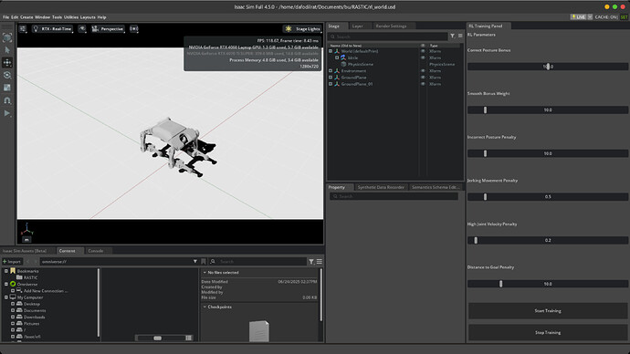

This is the project repo, I have changed the files a bit but the idea is still the same and the issue persists.
I have ditched RL world in favor of just building everything via the python calls so that should not be required anymore.
The ext folder contains the custom view extension that is causing the issue.
test.py file opens isaac sim via the api and starts the training.
The ext.py (the main file of the extension) pretty much does the same but with isaac sim aldready running and the extension loaded in.
command to run test.py ./python.sh -m alpha.exts.customView.customView.test
command to open isaac sim with custom extension ./isaac-sim.sh --ext-folder alpha/exts replace alpha with the folder name where the repo is cloned to.
Pressing the start training button should reproduce the error.
NOTE : you have to manually enable the extension in isaac sim. searching RL viewport under thrid party extension should show the extension
