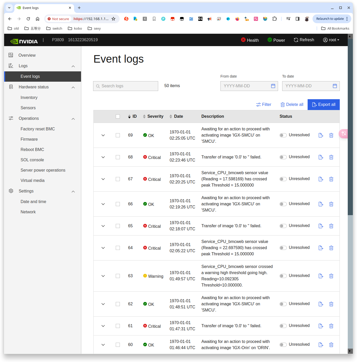

 The BMC still working, I try to update latest BMC firmware and install QSPI. Unfortunely, SMCU is fail to update.
  After updating, I still can't get UART log from BMC webui.
 FW version from webui
 Status from webui
 Log show critical event
“Service_CPU_bmcweb sensor value Reading has cross peek threashold”
Does this is problem?
And UART log from BMC don’t show up any log.
 bmc journalctl log

Hi david242,
It seems your BMC has been updated to the latest release(24.04-11-v3.2).
It is expected since updating SMCU through WebUI is not supported yet.
Please refer to SMCU update bug on BMC UI update - #8 by KevinFFF to update it if you are using C01 board.
