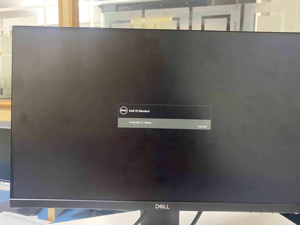

NO DP signal after IGX orin system reboot
We followed the manual re-flash and able to flash the new OS to IGX.
However, we are not able to see the display by connecting DP cable to GPU slots.
We are able to get the DP signal using iGPU slot.
I went through other issue threads in the forum, but this issue is not resolved.
Please can you guide us here to get the DP signal via GPU slot and install dGPU.

The manual flash was successful, but switching to dGPU using dp connection to port (14) is not happening as expected.
Please can you guide us from here
We have flashed the OS along with fireware updates according to:
  1. Install IGX-Software - NVIDIA Docs
  2. Install IGX-Software - NVIDIA Docs
In the last step of this setup, we connected DP cable to A6000 graphic card an rebooted, but not able to get DP signal from dGPU port (tried all four ports).
However, when we connect to iGPU, it boots up.
Please can anyone help us here. We are struggling to solve this past three weeks.

We tried three times.
in dGPU, the grub menu does not appear. We will get “No DP Signal”.
in iGPU, the grub menu appears and we will get two options to select, either of the option selected will go to again same mode saying “No DP Signal”.
Now, in iGPU the IGX system is not booting up to get the latest logs. Its like a deadlock situation now.
How to proceed from here?

During the installation you should connect to DP 8. Can you take fotos of the bootup screen, and the back of your IGX please? And share them here?
PFA
Thank you kjay.ajith.
The setup looks correct, and the IGX OS Image is the latest one.
Can you get a foto of the first screen where you can see the UEFI firmware version?
