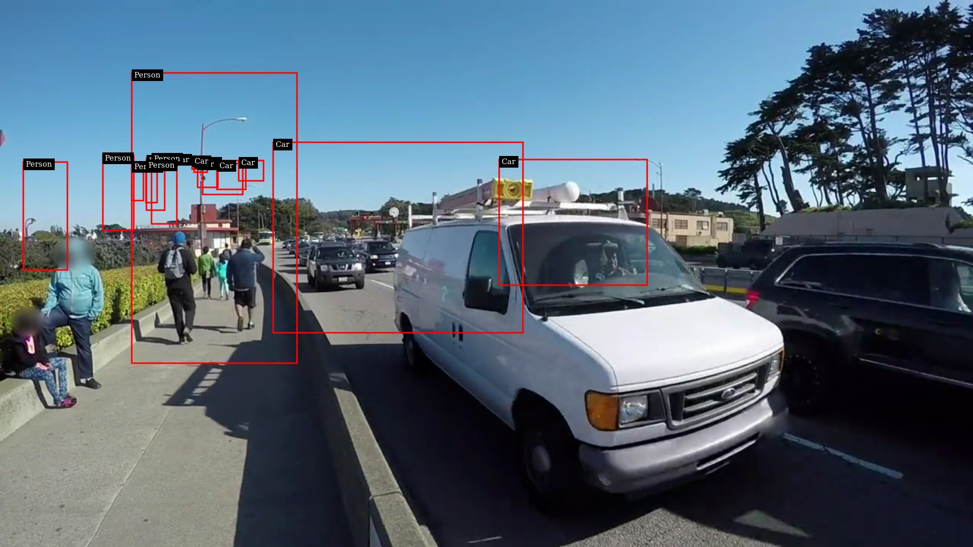

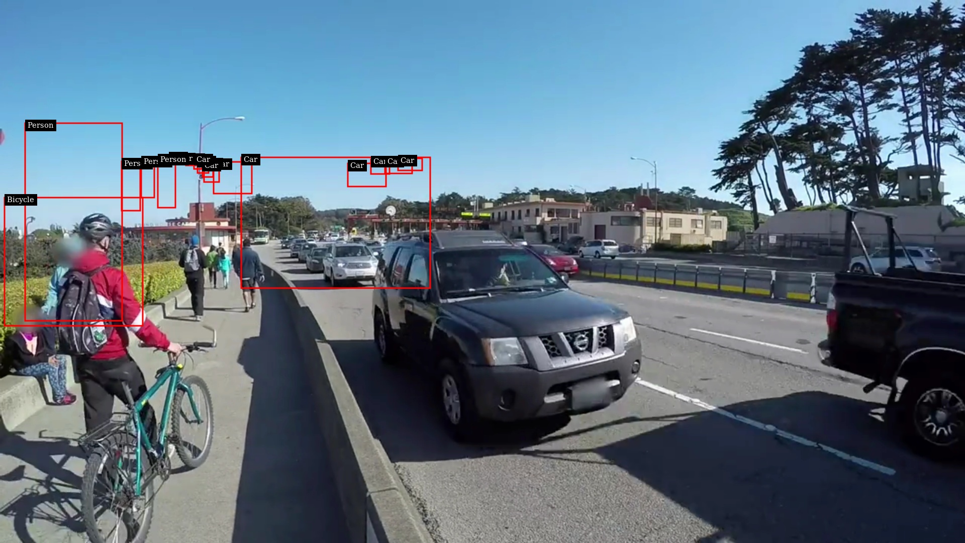

I am trying to save frames based on the detections. For frame extraction, I modified the code using deepstream_opencv_text.c. With that I am using NvBufSurfTransformRect to get the bounding boxes.
The problem is with the bounding boxes, the bounding boxes gets shifted a bit in the extracted frames and comes out to be correct in the streaming video.
Please find the attached code below

This issue may be related to the incompatibility between the tee plugin and the tiler plugin, and we are investigating a similar issue 291406.
The tee plugin is just add the ref count of the gstbuffer. It’s not really copy the gstbuffer. So if you processed the image in one branch, the image in the other branch will be affected.
You need to add nvvideoconvert plugin with disable-passthrough=1 after the tee plugin.
Hello, thank you for your reply.
My pipeline is
Source → streammux → queue1–> pgie → tee
tee–>queue2–>tiler–>queue3–>nvvidconv–>queue4–>nvosd–>queue5–>transform–>sink
tee–>queue6–>nvvidconv2–>queue7–>nvosd2–>queue8–>vidconv–>encoder–>fakesink
So, my probe function for image extraction is attached to fakesink pipeline, on vidconv. As you mentioned in the solution, I tried to set the property “disable-passthrough” for nvvidconv2 and vidconv, as 1. But still I am getting the same results. Everything is working fine for tiler display, but with image extraction the bounding boxes are not at the correct position.
There is no disable-passthrough attributes for the nvvidconv plugin. You can try to use the nvvideoconvert plugin.
The root cause of this problem is that the tee plugin does not deep copy the gstbuffer. So you need to add a deep copy plugin after the tee plugin.
