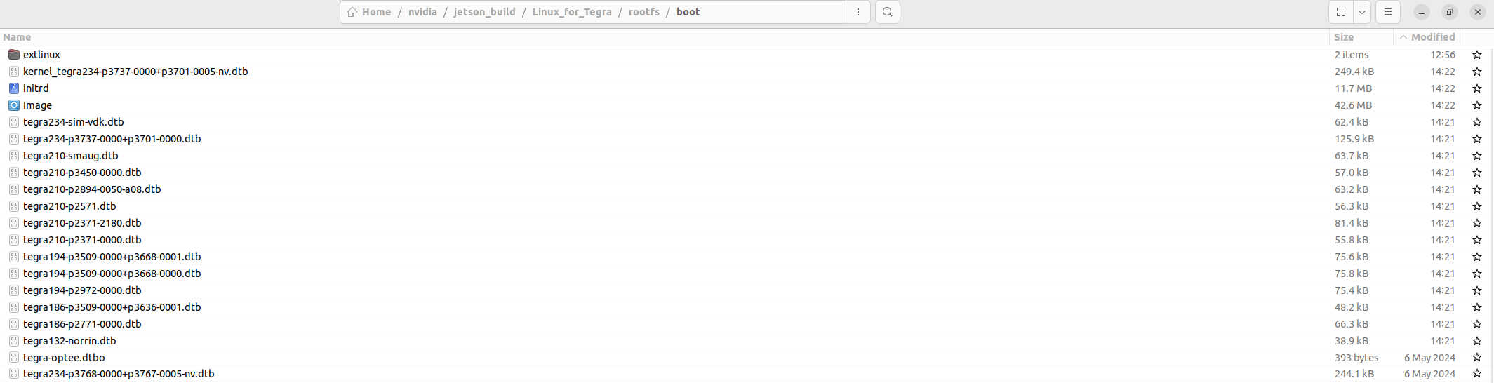

I have been able to flash the full root file system using initrd as you suggested. this is the command I used:
sudo ./tools/kernel_flash/l4t_initrd_flash.sh--external-device nvme0n1p1 -c ./tools/kernel_flash/flash_l4t_external.xml -p “-c bootloader/generic/cfg/flash_t234_qspi.xml” –showlogs --network usb0 jetson-agx-orin-devkit nvme0n1p1
This did move the mcp2515 kernel module drivers over to the target finally and it definitely cleared out the SSD because I had to set up a new user name and password on boot. So great news!
I saw that I was modifying the wrong DTSI folder at Linux_for_Tegra/source/hardware/nvidia/t23x/nv-public/nv-platform/
I was able to figure out which dtb file my Jetson is using via the following command : ls – l boot/dtbwhich yields the following file as one of the responses:
tegra234-p3737-0000+p3701-0000.dts
I have begun modifying this file and finally I am getting some relevant warnings that we can debug when I issue the command : make O=out -j$(nproc) Image dtbs modules

Here are the files that are modified by my build process and placed in the boot folder, you can see the data stamps are more recent on the ones that are modified:
So with that said, @KevinFFF:
Can you please confirm the DTSI or DTS file I should be modifying and the location that file resides in assuming that I will compile it from source on the host using the steps described in my previous post here?
