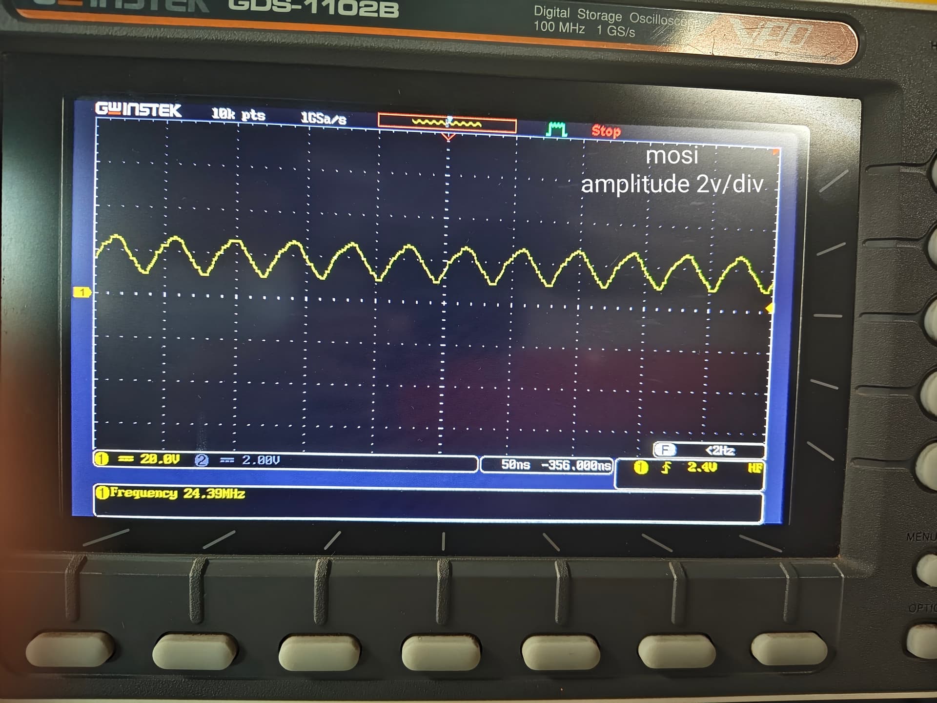

When the kernel communicates with the external device after applying the device tree, the CLK signal amplitude does not reach 3.3 V, and the MISO signal does not appear as a pulse. Is there any additional configuration needed in the SPI node of the device tree?
I can attach the waveforms for reference.
Could we get you final dts that actually runs on the board?
Please see this:
extracted_proc.dts.txt (313.7 KB)
Hi ajin.a,
Please remove the following part in the spi@3230000 node of your device tree.
			prod-settings {
				#prod-cells = <0x04>;
				prod {
					prod = <0x00 0x194 0x80000000 0x00>;
			mm6108@0 {
				spi-max-frequency = <0x2faf080>;
				compatible = "morse,mm610x-spi";
				status = "okay";
				reg = <0x00>;
				phandle = <0x37a>;
				spi-irq-gpios = <0xf3 0x7d 0x00>;
-			spi@0 {
-				spi-max-frequency = <0x2faf080>;
-				compatible = "tegra-spidev";
-				status = "disabled";
-				reg = <0x00>;
-				controller-data {
-					nvidia,enable-hw-based-cs;
-					nvidia,tx-clk-tap-delay = <0x00>;
-					nvidia,rx-clk-tap-delay = <0x10>;
It seems you want to use SPI3_CS0 for mm6108 SPI device.
You should just keep one node for that.
Please share the full dmesg to check if your driver can be probed correctly.
Thank you. I have figured out that spi communication is woking well. Now my concern is about the spi-irq gpios property added inside the spi node.
