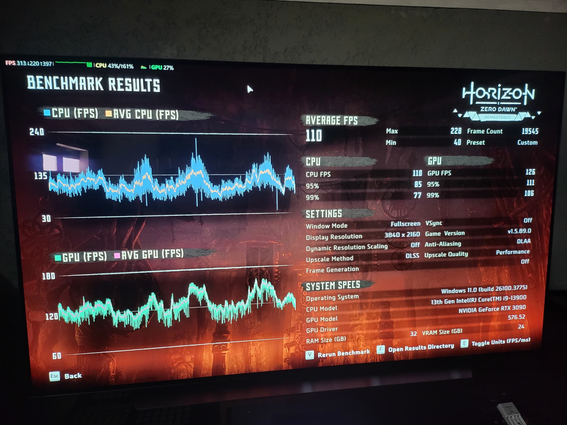

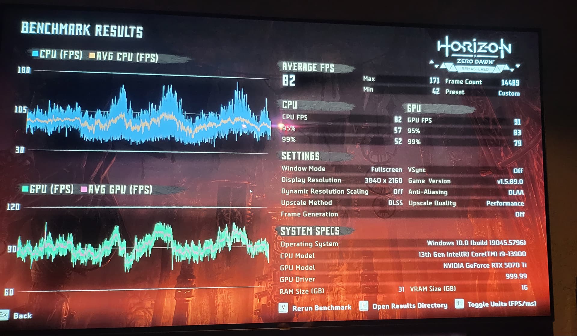

I really wasn’t expecting such a difference. These are two identical VMs — I only use virtual machines.
The Windows 11 VM outperforms any of the Linux ones. What’s disappointing is the 5070 Ti result on Linux.
I don’t understand the power draw of the 5070 Ti under Linux. In some games, like Horizon Zero Dawn Remastered, it only hovers around 200W for me. If I understand correctly, that means performance is being left on the table.
3090 Windows 11 VM
3090 Linux Fedora 42/Cachyos/endeavourOS (it doesn’t matter) VM
5070ti Windows 11 VM
5070ti Linux Fedora 42/Cachyos/endeavourOS (it doesn’t matter) VM

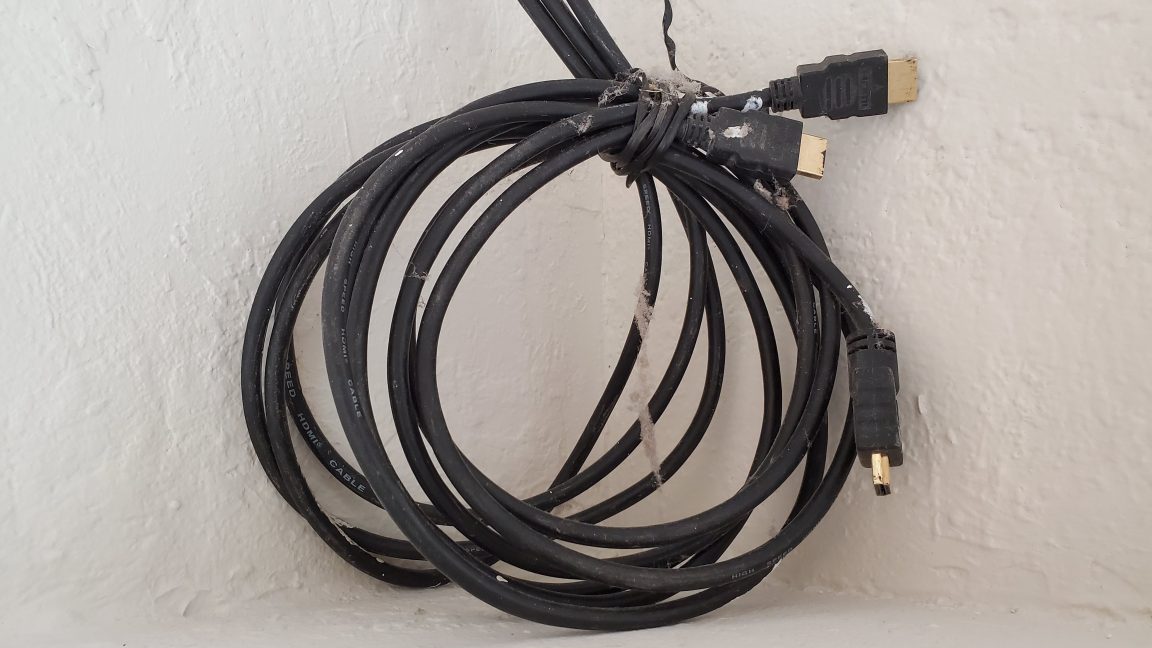

I can’t. No hdmi 2.1 under linux if not I would have changed yesterday..
Could use 120hz if you only have a 144hz panel. If it’s 240+ that definitely hurts though. :(
Not that. My monitor is my TV. It only has hdmi and for VRR to work (yes I tried DP to HDMI adapters) I have to use hdmi. AMDs don’t give you hdmi 2.1 + vrr under linux.

A 47.5% performance regression for the RTX 5070 Ti…🤡
And there’s people still insisting the regressions are “only” around 20%.

It’s not AMD, it’s HDMI Forum being openly hostile towards Linux and other open-source implementations:
Nvidia is able to do it because its drivers are not open-source.
Generally “HDMI on Linux” should be considered an oxymoron: don’t support HDMI forum and their proprietary sh*t and demand DP/USB-C input on your display (ie: don’t buy displays without them).
I know. I was probably one of the first—if not the very first—person to bring up the issue, all the way back when the RX 6900 XT was released directly on the kernel forum. Unfortunately there are no 77 inch oleds with DP.
