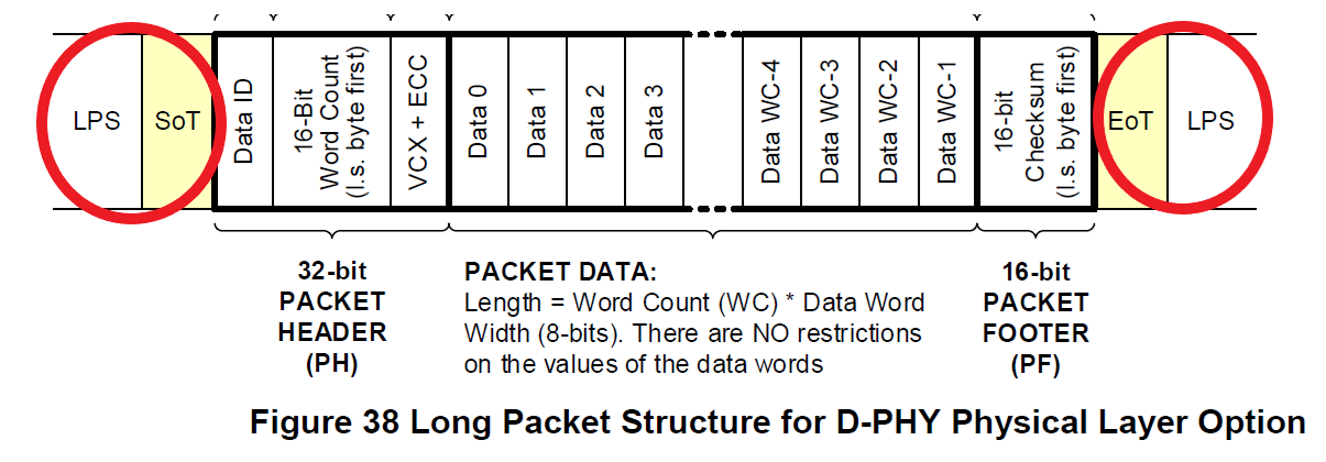

LP state is required between CSI-2 packets. Does the device really sent out only ONE very long packet? Per the CSI-2 spec, the largest packet size is 65536 bytes.
Currently NVCSI design doesn’t support LRTE feature, so after the packet complete, all the following data are dropped if not return to LP11. The watchdog timer can be disabled and FIFO will not overflow.

The device sends out short and long packets, but it stays in HS state. After the device sends a Frame Start short synchronization packet, it stays in HS state and then sends a Line Start short synchronization packet then sends a Long Packet. The time between these packets can vary. Would this be an issue? Is returning to the LP state between CSI-2 packets a requirement by the NVCSI block?
What is the LRTE feature?
No we don’t support this. It violate the CSI-2 spec. LPS is required between packet.
LRTE is a feature in CSI-2 v2.0, it allow to not enter LPS between packet, but there is still special code required to insert between packet.
Thanks for the confirmation.
