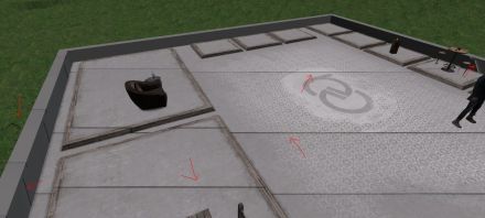

Following a number of reports from Firestorm viewer users, I installed the 516.40 driver update on Win11.
I have tested with the viewer I work on (Firestorm viewer) and the upstream official Second Life viewer from Linden Lab.
Both exhibit the same issues
Screen capture - 760b0faf6c2a6a88e9352204f087e8b0 - Gyazo shows the effect.

I’m having the same issue. Did not happen until after I updated my drivers today.
Same issue here… just updated drivers to 516.40 for GeForce
My rig: Screenshot - 6e86cf290445637b33b6150010ba2539 - Gyazo
I am getting the exact same result, and this is not just the firestorm viewer, the Black Dragon viewer is having the same issue…
https://i.gyazo.com/99440c5a5f11ffd86e306e51a846222d.png
Im having problems with newest driver when i play wolfenstein 2 new colossus ,my frame rates dropoed from 144 to 20fps for no reason
yes having the same issue with Firestorm after updating to this version, rolling back to previous version all works as it should.
Same issue with the latest Game Ready drivers and Windows 11.
same issue! here drivers 516.40 WHQL / windows 11
firestorm viewer and official viewer. (Latest version).
Same sepcs and same issue. Had to rollback to 512.95, this fixed the issue.

same issue here,
driver update causing visual artifacts such as lighting circles on my avatar (looks pretty cool, heh)
latest firestorm viewerx64 6.5.3.65658 & latest Official SL viewer (Open GL), same issues on both.
screen capture
Firestorm-Releasex64 6.5.3.65658 - CandyflossFifi - Google Chrome (gyazo.com)
windows 10 / drivers 516.40
advanced lighting enabled
ultra
LOD 2.5
draw 128
Same driver version, exact same issues. Running Windows 11 22H2.
Additional issue: avatars flickering in and out of view, even when closeby.

My identical problem happens only when I have Advanced Lighting Model enabled.
I’m glad I’m not alone!
EDIT: Rolling back to 512.95 fixed the issue. Thank you, all.
I’ve got the same. Noticed it last night when I did an update. Turning Advanced lighting model off does make it go away but, I wouldn’t really consider that a “fix”… -shrugs-

TYVM for the hint, had to struggle a little (never did a video rollback before) but rolling back to your same version saved my SL evening.

Same results. same current reported drivers. thought it was firestorm settings at first, been happening since i updated drivers on 6/15
I used nvclean install to install an older driver, 512.95 in my case it has been working well so far if I have issues ill revert to an older driver for the time being. It also allows you to create a driver installer if someone less tech-savvy needs a driver, I typically use the installers by NVIDIA but in this case till they can fix the issues this is a fairly easy work around till they fix the issue, i am going to tell you it might cause your framerates to drop a bit ,but its the most elegant and clean solution ive found so far
The 516.59 drivers that were released today appear to address this issue. Inara Pey’s blog post has more details.
I have confirmed that I no longer see the artefacts once I have installed the latest drivers (Win11). Tested on both the current Firestorm release and an unreleased development build.
Thank you nvidia team for a quick fix (and thank you Minecraft for being affected too as I suspect that helped the motivation :-)
