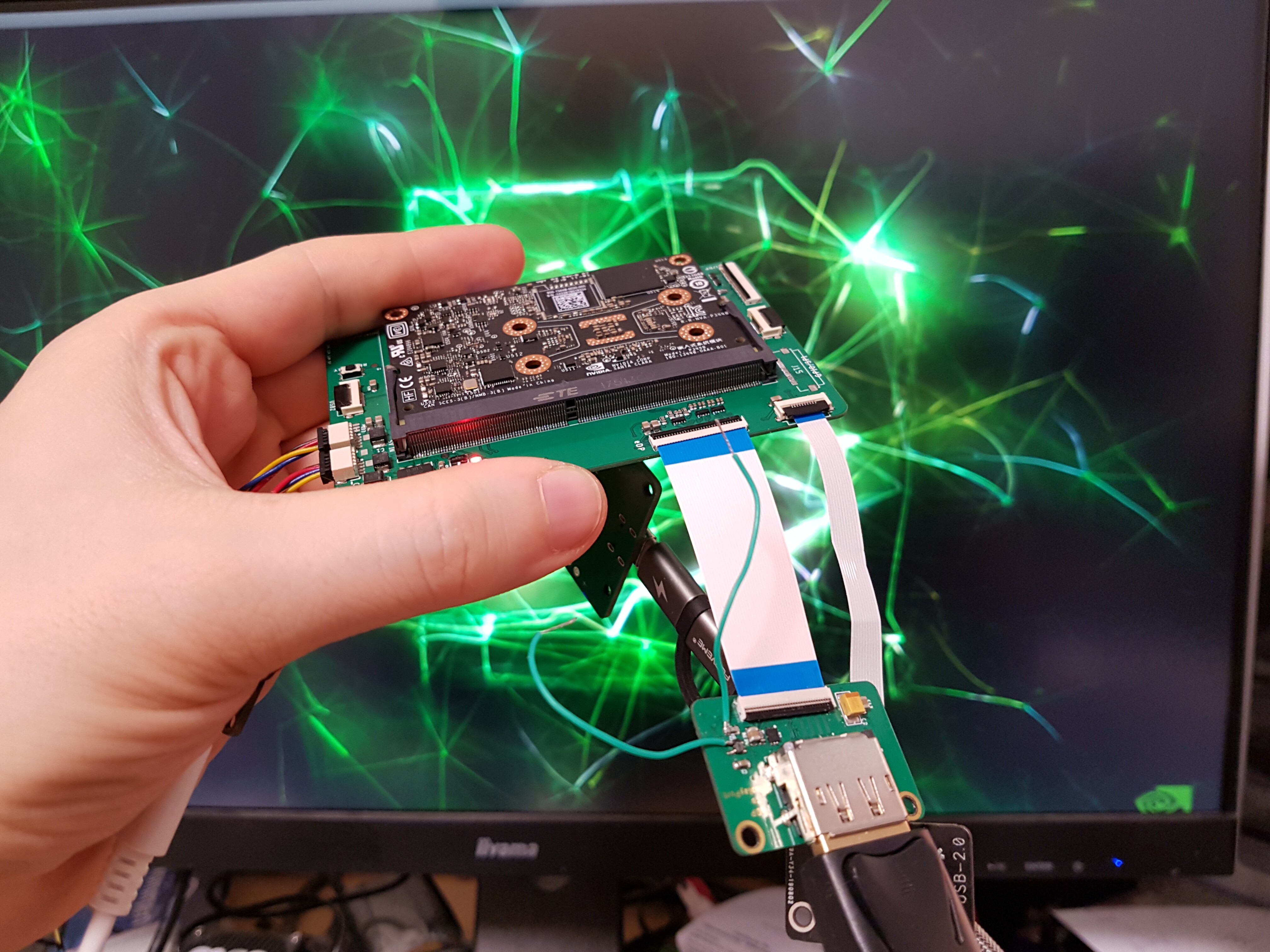

Yes I remember that you mentioned DT changes for eDP but I understood those to be only regarding the backlight control pins.
Sorry if my wording about the display setup was confusing. I only ever have a single display or lcd panel connected and am only using DP0 right now. The only difference is the connector I use and of course a standard desktop monitor vs an eDP panel. I attached a picture of how it looks like with a DP connector attached, hopefully that clears things up regarding the hardware setup.
I copied over the prod settings from that file but after flashing I still get this message in the bootlog that prod_c_hbr is missing.
This is how my sor looks like right now:

This is the other possible setup for the carrier with a DP connection. The other option is an adapter to eDP as seen in the picture of the first post.
