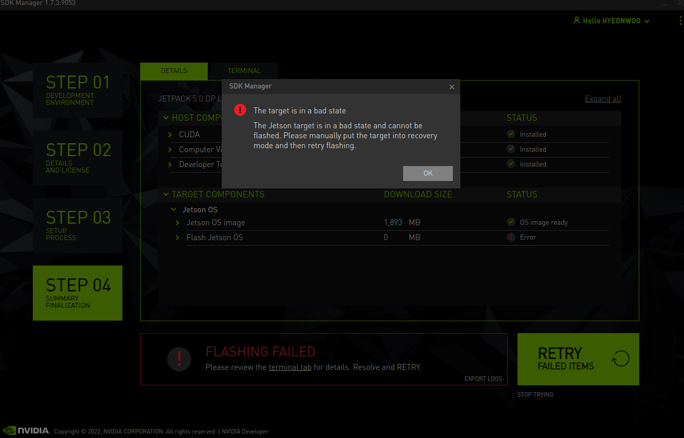

Hello, I tried to install OS using sdk manager to use Nx Module, but it didn’t work.
I think it’s an eMMC problem.
And I have a question
1, Can I access the eMMC with the Nx Module on the board?
- Nx Module connected to board but no light.

If this is your first time flashing jetson NX, please refer to quick start guide.
Need to know something like how to put the board into recovery mode.
If your using a custom carrier board (not devkit), you may need to comment out all the EEPROM stuff at the bottom of the following files.
bootloader/tegra194-mb1-bct-misc-flash.cfg
bootloader/tegra194-mb1-bct-misc-l4t.cfg
bootloader/t186ref/BCT/tegra194-mb1-bct-misc-flash.cfg
bootloader/t186ref/BCT/tegra194-mb1-bct-misc-l4t.cfg
This applies to Jetpack 5.0 only.
