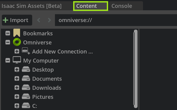

@rodscoimbra i am just another user, but could you elaborate the exact steps you are taking to open or edit the file? i think it may help clarify aspects such as “file browser” and “edit button” you are referring to.
when i try to open or edit an OpenUSD file in a kit app like Isaac Sim, i typically double click on the USD file via the Content browser via GUI

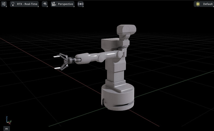

just to follow up, i have no issue opening up the USD file you provided as .txt using Isaac Sim 4.5.0 on Windows (with the method i described above):
Sorry if that wasn’t clear. What you described is exactly what I meant when I said “I try to insert the USD file into the stage via the file browser.”
For the “Edit” button, you also find the file through the Content browser GUI, but instead of double-clicking it, you right-click on the file and select Edit.
Yeah, that’s what happens on two of my machines as well. I’m not sure why it doesn’t work on the others. On the machines where it works, one is running Windows and the other Ubuntu 24.04.
As for the ones where it doesn’t work, one is the machine I mentioned earlier, running Ubuntu 20.04, and the other is another machine running Ubuntu 24.04.
