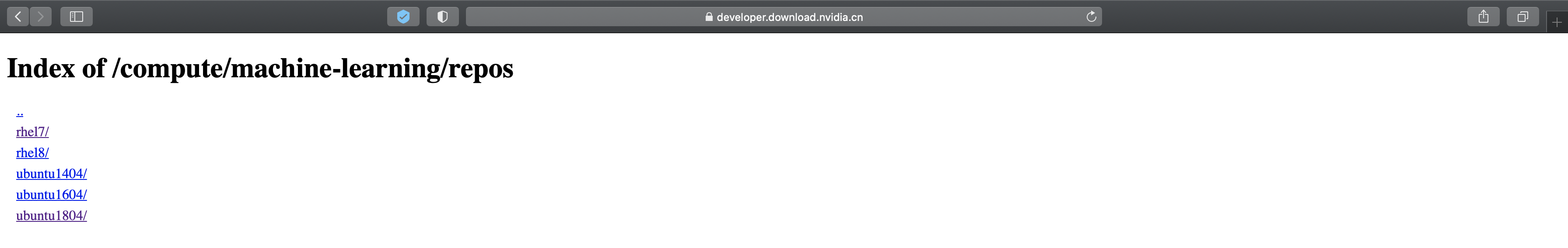

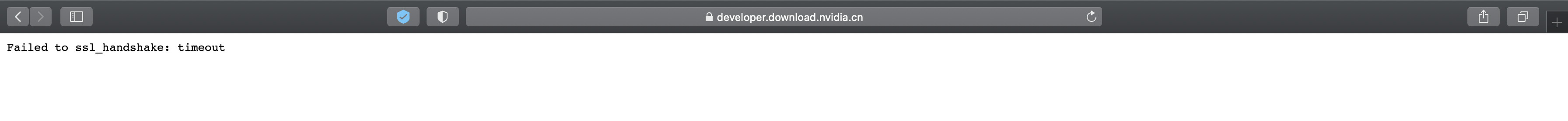

Today we hit a new round of Failed to ssl_handshake: timeout (not always, but > 90%)
This is what safari got for https://developer.download.nvidia.cn/compute/machine-learning/repos (redirected from https://developer.download.nvidia.com/compute/machine-learning/repos)
Occasionally I can get this when lucky:
And there’re more corrupted cases:

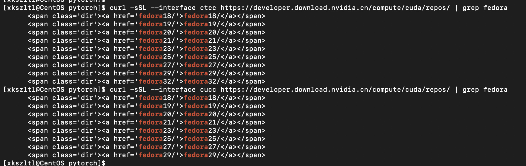

For example I can randomly get different “valid” response.
This example shows result returned by different ISP (China Telcom/China Unicom, 2 largest ISP in China) can be different, China Unicom result does not have Fedora 32 listed (response was not truncated, it simply don’t have that entry in list).
This example shows sometimes the result can be good from China Unicom, but randomly.
Result returned from CERNET (another major ISP mainly for university in China) seems to be good.

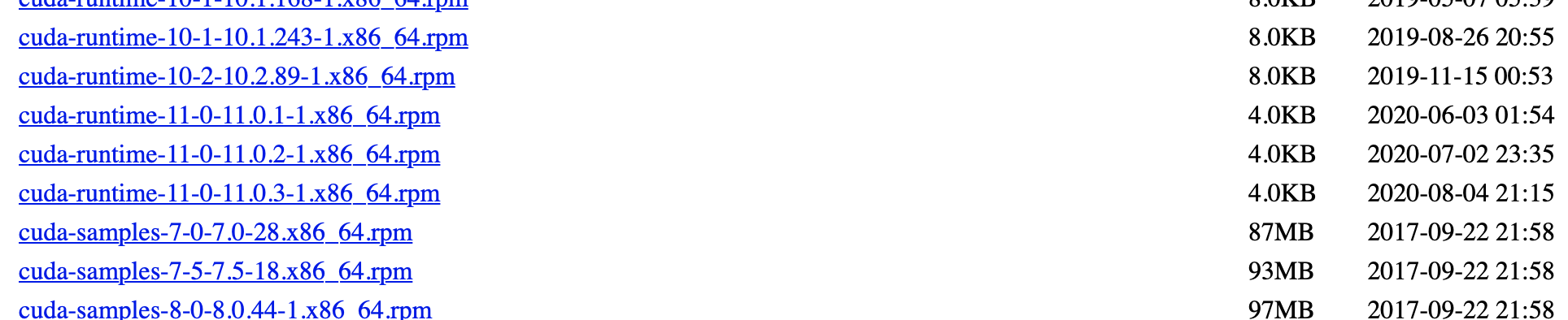

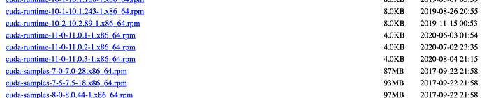

And some pkgs also keep come and go.
For example, only a small potion of response has cuda-runtime-11-1, majority of them only have up to 11-0 as below.
This is purely random, every curl has a different answer.
