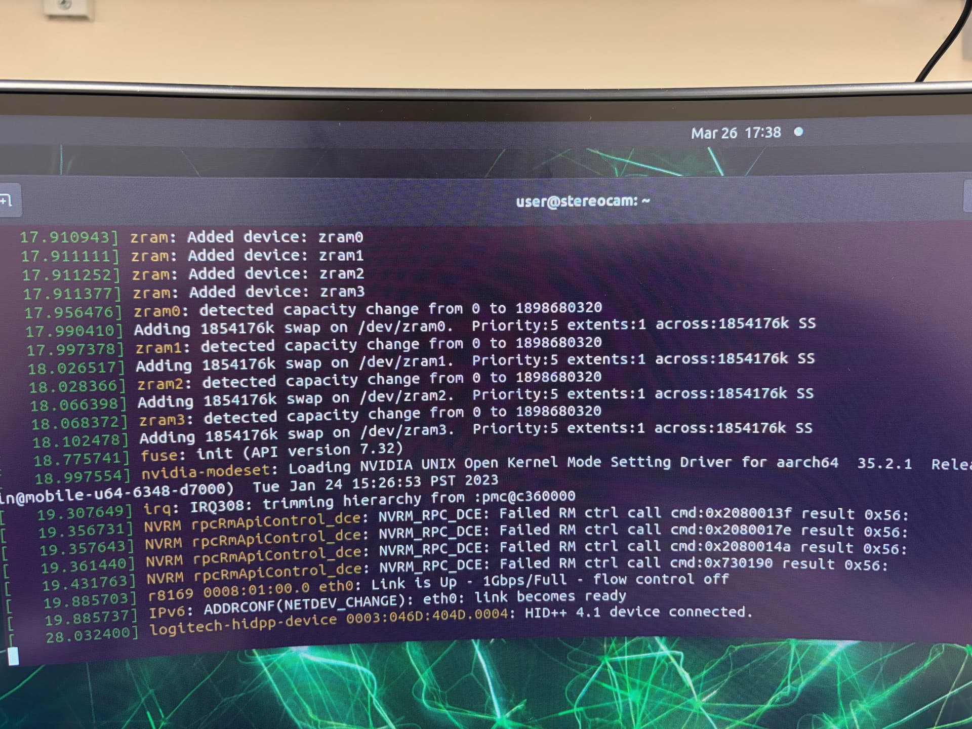

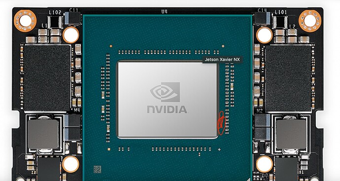

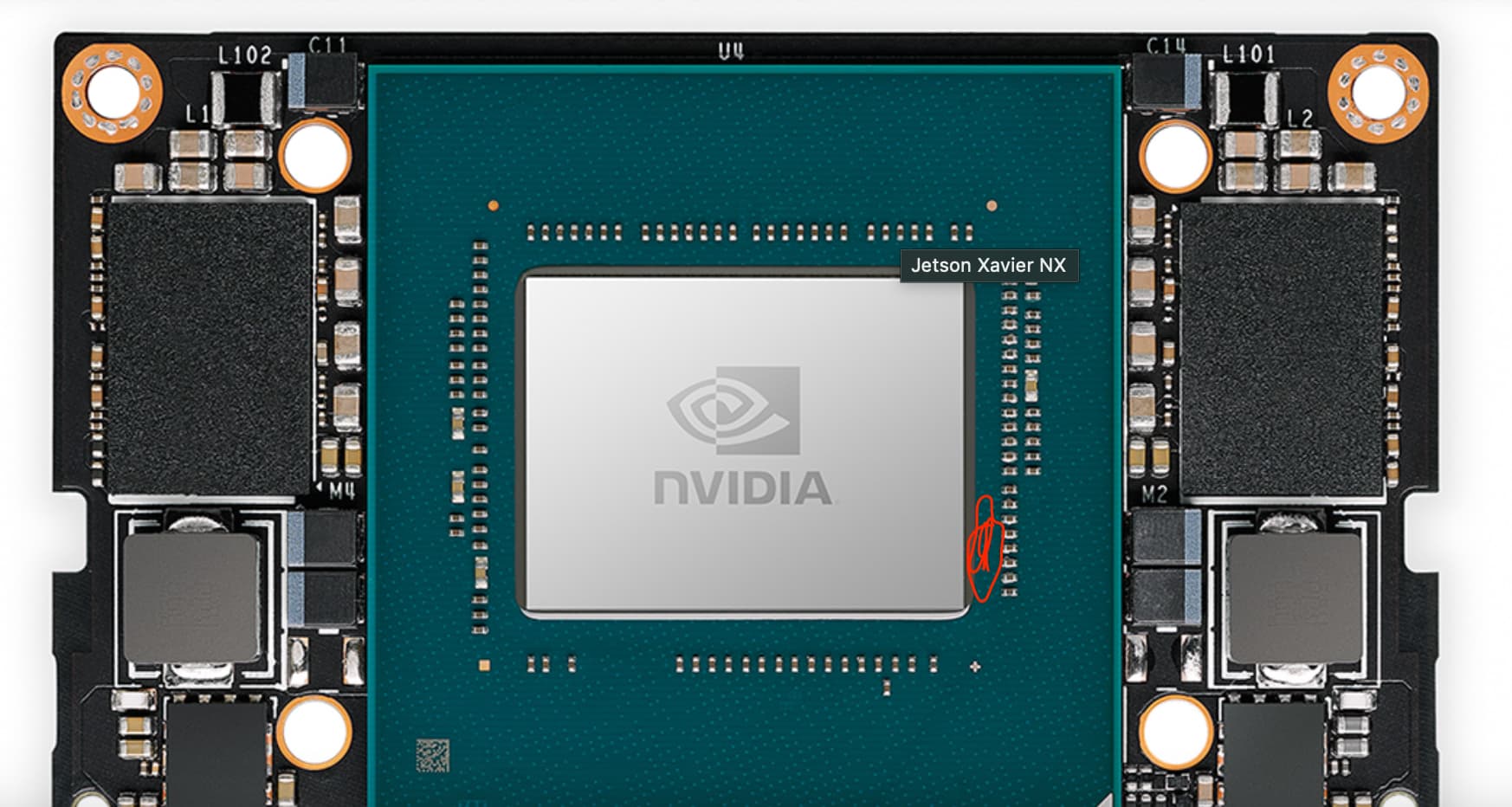

However there is a new issue where the device will reboot itself every 40 sec - 1.5 minutes. When I swapped out the fan and re-applied the thermal paste, I did get some on the Jetson Xavier NX SOM (I attached a pic below for reference). Would this cause a rebooting issue?
I also ran the “sudo dmesg -w” command to print out the device logs in terminal before the reboot, and this is what pops up:
For reboot issue, please open another topic to discuss in details.
You can share the full serial console log when you hit the issue.
