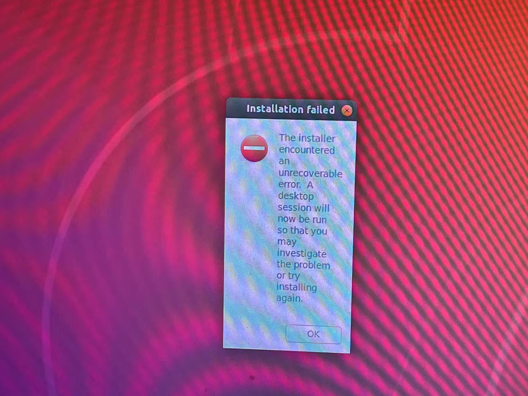

Flashed image successfully, but Jetson Nano 2GB fails to install on boot and can't be used
I’m setting up the jetson nano 2gb, I have the jetson-nano-2gb-jp461-sd-card-image.zip flashed with etcher into a 64gb sandisk extreme sd card and it said successful. But when I put the sd card into the jetson nano 2gb and also connected the keyboard, mouse and hdmi to it, and when I connect the official rasberry pi 5V5A power supply, it booted and said failed to install. so I cannot use it. what should I do.

Please find a x86 host and flash your Jetson device with sdkmangager.
Only this method would fix the problem. Sdcard image didn’t really flash anything there.
