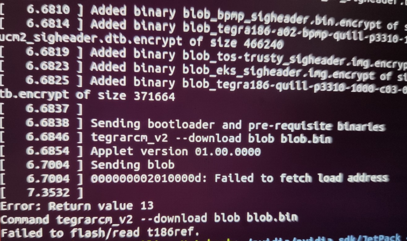

When i tried to replicate it now to another new 3 (Jetson TX2 + Auvidea J120) boards.
I tried to do i according to manual, but i quickly got this error.
So i have found here
Flash TX2 failed with Error: Return value 13 - Jetson & Embedded Systems / Jetson TX2 - NVIDIA Developer Forums
that first i need to flash jetson with same releases of JetPack (propably with auvidea package) as they are on device that is being cloned.
I managed to do it in the past with auvidea manual provided with firmwares (dowload JetPack, copy kernel_out, then apply binaries and run flash.sh)
But right now it doesnt work.
Where i try to flash JetPack 4.2 or 4.3 with or without coresponding auvidea package it fails (stucks forever) at
It doesnt matter if i do it via sdk manager or just flash.sh command.

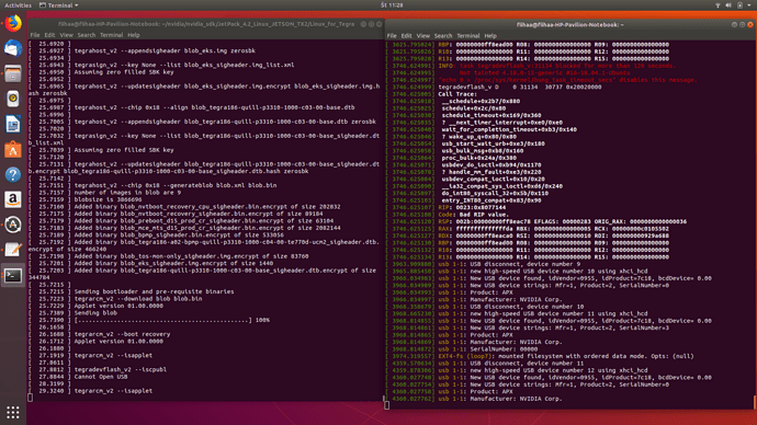

Ok. So i tried with different computer and this is in dmesg --follow messages when it freezes

[ 4713.236479] INFO: task tegrarcm_v2:21121 blocked for more than 120 seconds.
[ 4713.236487] Not tainted 5.4.0-58-generic #64~18.04.1-Ubuntu
[ 4713.236490] “echo 0 > /proc/sys/kernel/hung_task_timeout_secs” disables this message.
[ 4713.236494] tegrarcm_v2 D 0 21121 20962 0x20020000
[ 4713.236499] Call Trace:
[ 4713.236513] __schedule+0x293/0x720
[ 4713.236519] schedule+0x33/0xa0
[ 4713.236523] schedule_timeout+0x15d/0x320
[ 4713.236529] ? __next_timer_interrupt+0xe0/0xe0
[ 4713.236535] wait_for_completion_timeout+0xb3/0x140
[ 4713.236541] ? wake_up_q+0x80/0x80
[ 4713.236547] usb_start_wait_urb+0xe3/0x180
[ 4713.236552] usb_bulk_msg+0xb8/0x160
[ 4713.236557] proc_bulk+0x257/0x3a0
[ 4713.236563] usbdev_do_ioctl+0x93d/0x1490
[ 4713.236569] ? handle_mm_fault+0xcb/0x210
[ 4713.236574] usbdev_compat_ioctl+0x10/0x20
[ 4713.236580] __ia32_compat_sys_ioctl+0x105/0x230
[ 4713.236587] do_int80_syscall_32+0x5b/0x130
[ 4713.236593] entry_INT80_compat+0x85/0x90
[ 4713.236597] RIP: 0023:0x807a434
[ 4713.236609] Code: Bad RIP value.
[ 4713.236611] RSP: 002b:00000000ffe4f298 EFLAGS: 00000283 ORIG_RAX: 0000000000000036
[ 4713.236615] RAX: ffffffffffffffda RBX: 0000000000000005 RCX: 00000000c0105502
[ 4713.236617] RDX: 00000000ffe4f2c0 RSI: 0000000000000010 RDI: 0000000009631688
[ 4713.236619] RBP: 00000000ffe4f320 R08: 0000000000000000 R09: 0000000000000000
[ 4713.236621] R10: 0000000000000000 R11: 0000000000000000 R12: 0000000000000000
[ 4713.236623] R13: 0000000000000000 R14: 0000000000000000 R15: 0000000000000000
[ 4834.069536] INFO: task tegrarcm_v2:21121 blocked for more than 241 seconds.
[ 4834.069544] Not tainted 5.4.0-58-generic #64~18.04.1-Ubuntu
[ 4834.069546] “echo 0 > /proc/sys/kernel/hung_task_timeout_secs” disables this message.
[ 4834.069550] tegrarcm_v2 D 0 21121 20962 0x20020000
[ 4834.069555] Call Trace:
[ 4834.069569] __schedule+0x293/0x720
[ 4834.069576] schedule+0x33/0xa0
[ 4834.069580] schedule_timeout+0x15d/0x320
[ 4834.069585] ? __next_timer_interrupt+0xe0/0xe0
[ 4834.069592] wait_for_completion_timeout+0xb3/0x140
[ 4834.069597] ? wake_up_q+0x80/0x80
[ 4834.069603] usb_start_wait_urb+0xe3/0x180
[ 4834.069608] usb_bulk_msg+0xb8/0x160
[ 4834.069613] proc_bulk+0x257/0x3a0
[ 4834.069619] usbdev_do_ioctl+0x93d/0x1490
[ 4834.069625] ? handle_mm_fault+0xcb/0x210
[ 4834.069630] usbdev_compat_ioctl+0x10/0x20
[ 4834.069636] __ia32_compat_sys_ioctl+0x105/0x230
[ 4834.069643] do_int80_syscall_32+0x5b/0x130
[ 4834.069648] entry_INT80_compat+0x85/0x90
[ 4834.069653] RIP: 0023:0x807a434
[ 4834.069664] Code: Bad RIP value.
[ 4834.069667] RSP: 002b:00000000ffe4f298 EFLAGS: 00000283 ORIG_RAX: 0000000000000036
[ 4834.069671] RAX: ffffffffffffffda RBX: 0000000000000005 RCX: 00000000c0105502
[ 4834.069673] RDX: 00000000ffe4f2c0 RSI: 0000000000000010 RDI: 0000000009631688
[ 4834.069675] RBP: 00000000ffe4f320 R08: 0000000000000000 R09: 0000000000000000
[ 4834.069677] R10: 0000000000000000 R11: 0000000000000000 R12: 0000000000000000
[ 4834.069678] R13: 0000000000000000 R14: 0000000000000000 R15: 0000000000000000
Like that

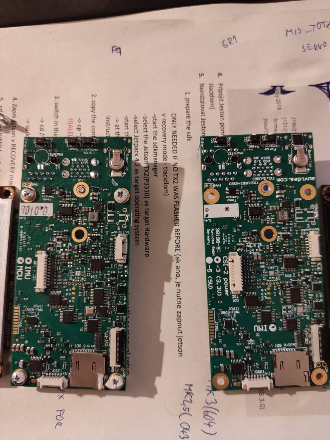

I would like to add some details.
  1. Half a year ago, i was able to flash jetson TX2 with auvidea j120 board from this pc.
  2. Only things i see that changed were:
    a, Propably older release of ubuntu 18.04.X (now have 18.04.5)
    b, Different version of SDK manager (previously 12.X, now tried with 13.X and 14.X because when i install 12.x it wont let me flash jetson without updating to newer version)

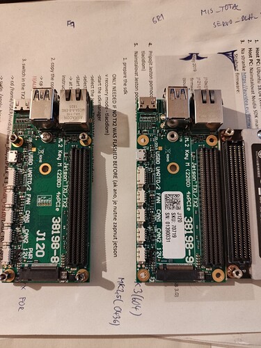

    c, different revisions of boards. (Previously was D00, now has D02 only)
    d, propably different revisions of AUVIDEA J120 boards (new is on the right)

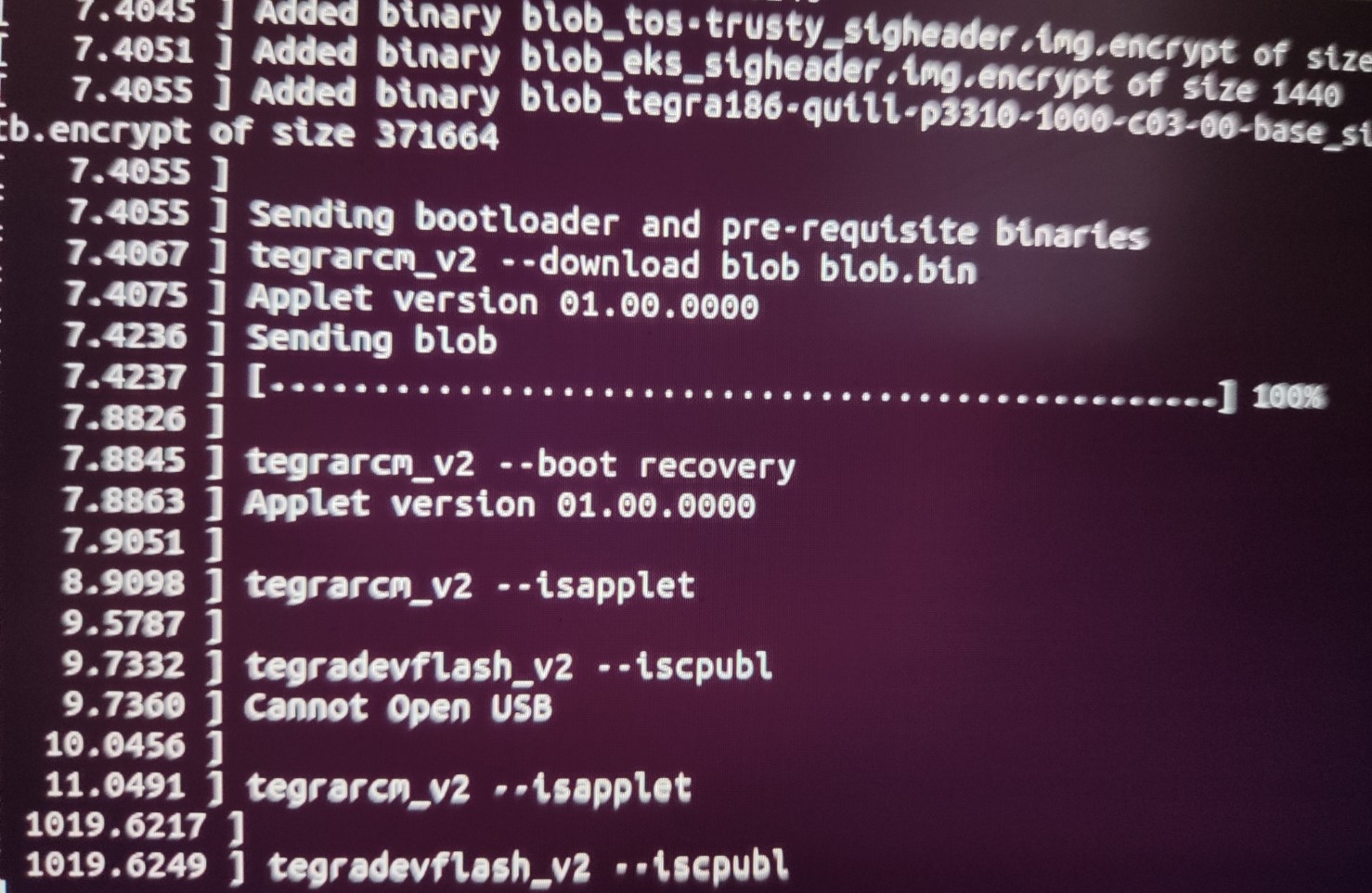

I actually made a video of whole flashing process. Maybe it will help someone understand my problem. Actually via SDK manager it stops at 99% forever and when updating manually. it also freezes at the last step forever.
JetsonTX2 problem - YouTube

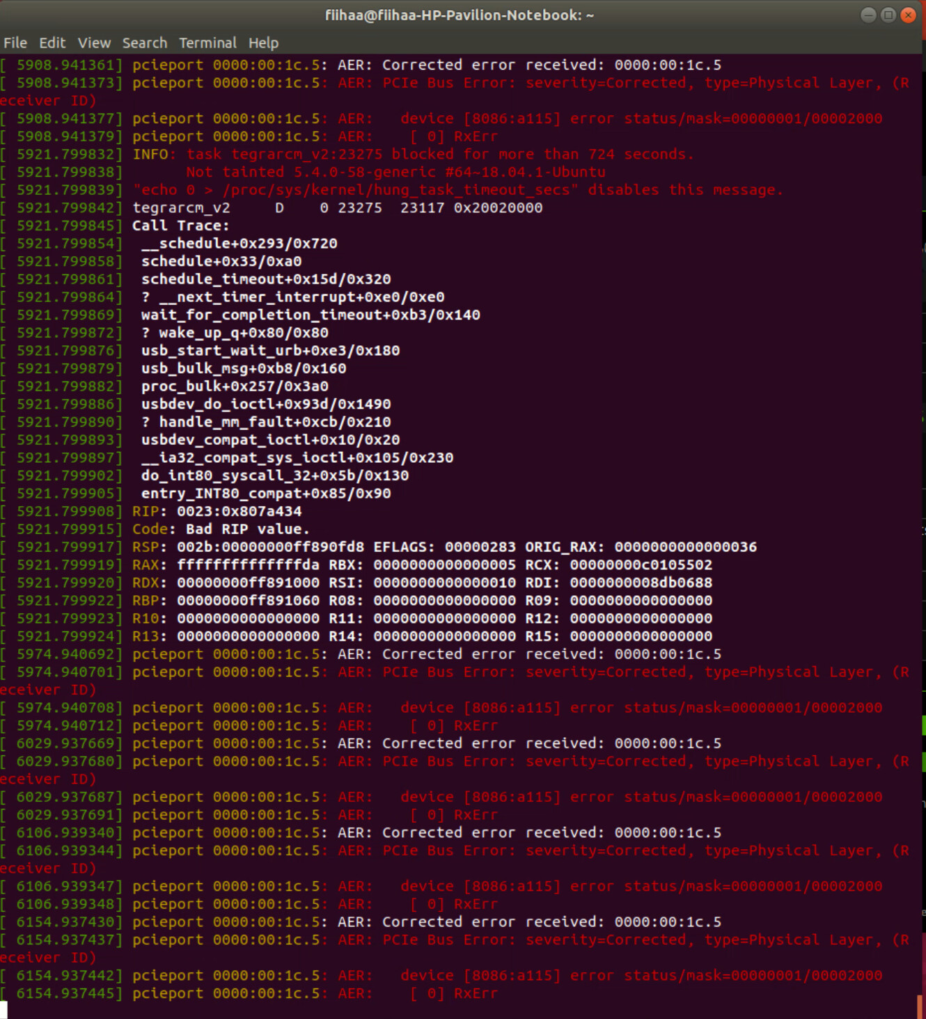

EDIT: Read the part about the PCIe errors before trying another flash. Need to know more about what is on the PCI bus.
Can you try without host “HOST COMPONENTS” , and without “Jetson SDK components” (e.g., CUDA, which can be installed later)? Try picking only “Jetson OS”.
I see a lot of errors in the actual flash step. The steps leading up to making it possible to flash (e.g., download of content) seem to be good. While converting the raw image file for the rootfs to sparse format there are many errors…there was a time in the past where the error message itself was a bug and it worked anyway, but this could still be relevant. On the host PC, from the “~/nvidia/nvidia_sdk/JetPack...version.../Linux_for_Tegra/” location (cd there first), see how much disk space you have:
df -H -T .

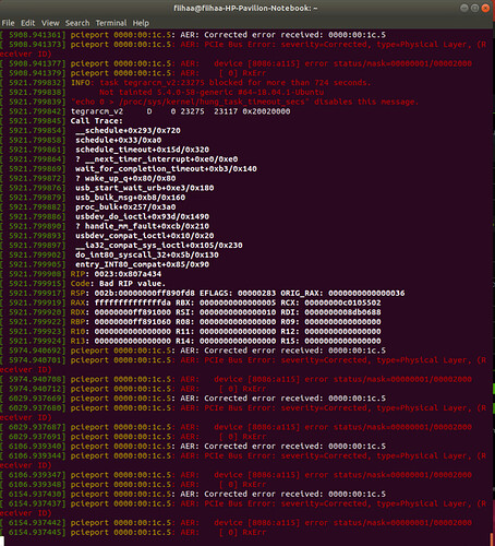

When you bring up the console on the host PC in the video, and dmesg shows the errors, am I correct that this is the dmesg of the host PC itself? What I see are PCIe errors, which are rather significant and (possibly) unrelated to the flash. The exception would be if the PCIe device failing is a USB card, and the card is used for the flash. This is a serious error no matter how you look at it, but it is something the Jetson and flash software have no control over. Even so, if the device is part of USB, then this would cause flash to fail. Can you provide more details on the host, especially anything related to USB and PCI?
The video is not of high enough resolution to see any details on the PCIe errors of the host PC, but if you were to simply log via this:
dmesg | tee host_dmesg_log.txt
…then you could post the log.
I dont have acces to jetson for the weekend, but i have a full resolution video.
And from that I was able make a screenshots of those errors.
I hope those are those you were asking for.
And btw yes. thats all on host pc
