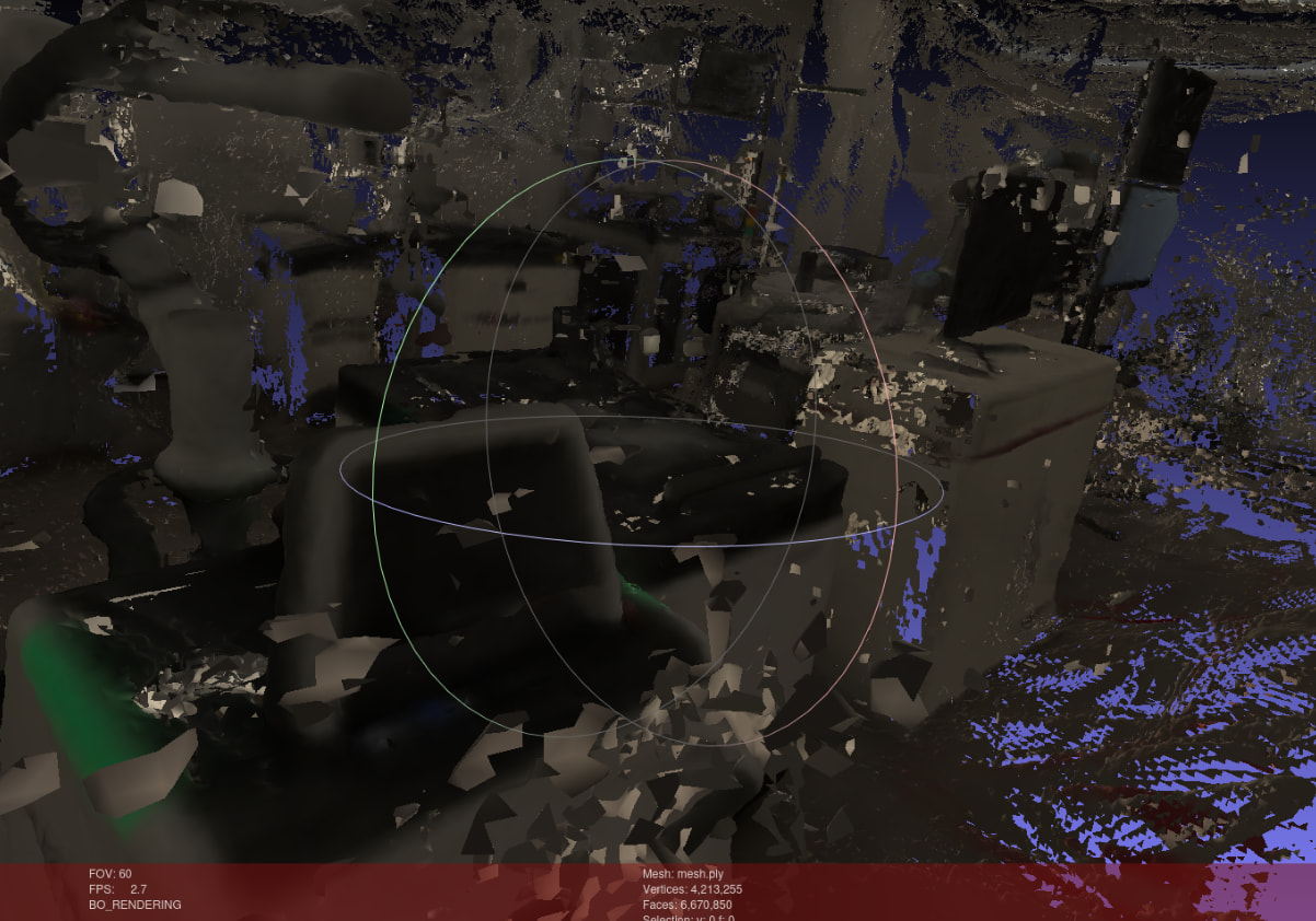

Environment: fvdb-reality-capture (latest), spatial video → 3DGS → tsdf_from_splats_dlnr → mesh
Problem: The output mesh looks as if a small mesh is being generated around each individual Gaussian splat rather than a clean, continuous surface.

We ran a side-by-side comparison on tsdf_from_splats_dlnr with two configs that reproduce exactly the “mesh-around-each-splat” artifact you’re seeing vs. a clean surface. Results below.
Comparison configs (mesh_compare.py)
Param “Bad” (noisy, splat-ish) “Good” (clean surface)
voxel_size 0.005 0.02
truncation 1.0 × voxel (=0.005) 4.0 × voxel (=0.08)
min_weight 1 3
prune_opacity None 0.1
Q2 — Parameter tuning
For indoor room-scale scenes the dominant factors, in order of impact:
  1. voxel_size — counter-intuitive, but going coarser helps a lot. 0.005 m tries to resolve detail finer than the splat noise floor and ends up carving a tiny isosurface around every Gaussian. 0.01–0.03 m is the sweet spot for room-scale; we used 0.02.
  2. truncation (a.k.a. truncation margin) — should be a multiple of voxel_size, not equal to it. A 1× truncation gives each splat its own little TSDF bubble. 3–4× voxel_size lets neighbouring splats’ SDFs blend into a single continuous surface. We used 4×.
  3. min_weight — raise it. min_weight=1 keeps every voxel a single splat touched (= floaters survive). min_weight=3 drops voxels that weren’t confirmed by multiple views/splats and removes most mid-air noise.
  4. Marching-cubes isolevel — not currently exposed as a tunable in tsdf_from_splats_dlnr; in practice the three params above dominate, so we didn’t need it.
So yes — truncation = ~4 × voxel_size is a good rule of thumb, and min_weight ≥ 3 is what you want to try.

There is a built-in pruning step: prune_opacity in the TSDF call. Setting prune_opacity=0.1 drops low-opacity Gaussians before they contribute to the SDF, which kills most of the airborne floaters at the source. This was the single biggest visual win in the comparison.
