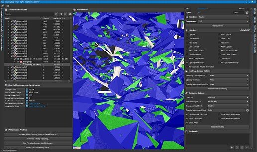

I’m trying to use Nsight Graphics to visualize my BVH with OMM, but I got two different result on Frame Debugger and Graphics Capture.
To reproduce this issue, I ran the NVIDIA OMM sample and attempted to visualize the acceleration structure:

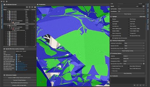

Clearly, the Frame Debugger (first image) provides the expected visualization where I can access the bit array and descriptors, which are essential for understanding the OMM structure. On the other hand, Graphics Capture does not show these details correctly.
This inconsistency has been holding me up for a whole day because initially, I relied on Graphics Capture and obtained incorrect results.
Could anyone help explain why there is such a difference and how to resolve it?
Hi, thanks for the report. Sorry for the inconvenience this caused! You’ve encountered a bug in 2025.3 that is already fixed for the next release. There is a workaround you can use in the meantime: it should work if you open the Ray Tracing Inspector after starting Live Replay. You have to make sure that you haven’t opened the RTI at all in that session before starting Live Replay. (In the next release it will work without requiring Live Replay.)
