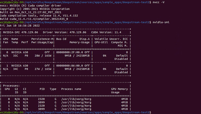

I have another question.When i run deepstream-test1, it shows
It seems like cuda has some problems?This is my cuda info
Can you find nvstreammux?
gst-inspect-1.0 nvstreammux
Did you use deepstream SDK 6.1? if yes, please upgrade the GPU driver to 510.47 or higher. cuda 11.6
I can find nvstreammux
I’m using deepstream 6.0, so i installed 470.129 and cuda 11.4
Did you use nvidia X server?
please follow this to check
Chapter 6. Configuring X for the NVIDIA Driver
Please use TensorRT 8.0.1 for Deepstream 6.0
