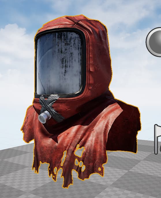

Hello. I’m having weird transparency issues with assets imported from Blender with the Alpha channel plugged in. Please help.
This is what it looks like in Blender:
And just for reference, in USD Composer:
And as usual I find a workaround right after creating the thread 🤣
  1. Find the UsdPreviewSurface material.
  2. Double-click to edit it and connect the Opacity Mask input to the same node as the Opacity input.
  3. Override the Blend Mode on all affected materials to ‘Masked’
Fixed.
Alternatively, you can also override the blend mode on UsdPreviewSurfaceTranslucentTwoSided so that it fixes all materials that inherit it.

I’m sorry to hear that. It looks like a normal display issue in Unreal Connect, but it should be caused by other 2 things:
  1. Blender did the wrong preview surface exporting for normal.
    I guess it doesn’t set a correct scale and bias for Normal texture. This’s a right normal exporting example

I will confirm the issue from Blender side.
  1. Unreal USD plugin did the wrong importing for the normal property of preview surface, but with a wrong blender exporting data, make it look right.
    We can see the normal texture is directly set to normal property. It looks right in Unreal, because Unreal will do normal sampling internally, but it’s not right in USD preview surface style for other platforms.
Anyway, thanks for helping us with a better Omniverse
Blender did have a bug with exporting the normal.

Blender has fixed the normal map issue on the preview surface material. It will go out in next release.
PreviewSurface or MDL? Because unless I did something wrong that material with broken normals was imported as MDL.
It’s the issue of Preview surface.
ah, so the issue I’m still having with MDL Normals is likely the one from this thread that’s already fixed.
Fixed in the latest UE5 Connector plugin. thanks!
