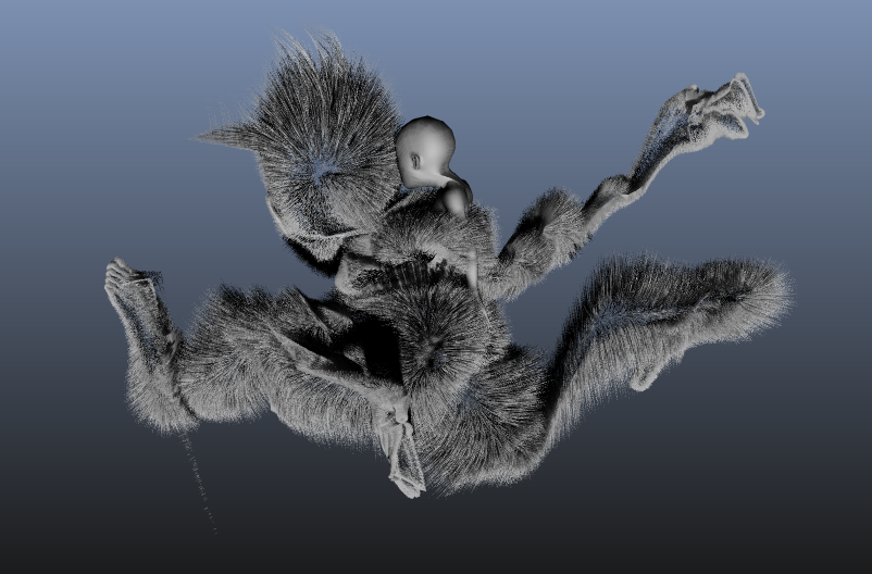

Hi, I’m not having that same issue but maybe something similar. I’m trying to export my FBX and APX files from 3Ds Max, however I consistently get this weird thing where my growth mesh is way too big and doesn’t match the graphic mesh as it does when I view it in 3ds max. I’m a mid-level noob with this.
You can see in this screenshot that the growth mesh is way off. I also experimented with Manjaladon and as you can see in the screenshot, the growth mesh is much bigger with the graphic mesh of the manjaladon nested inside.
