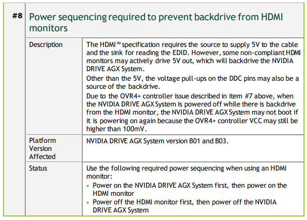

Currently the HDMI port for A isn’t outputting anything. We believe it has something to do regarding X11. Flashing would probably be the easiest solution but if possible I’d like to avoid that for now.
