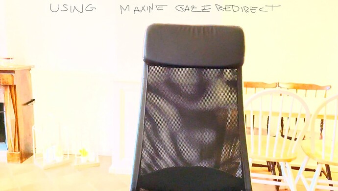

Hello ! I tried Gaze Redirect on a video i recorded today with my phone. The result is very “white” I don’t know why. How can I change this setting ?
Thanks !

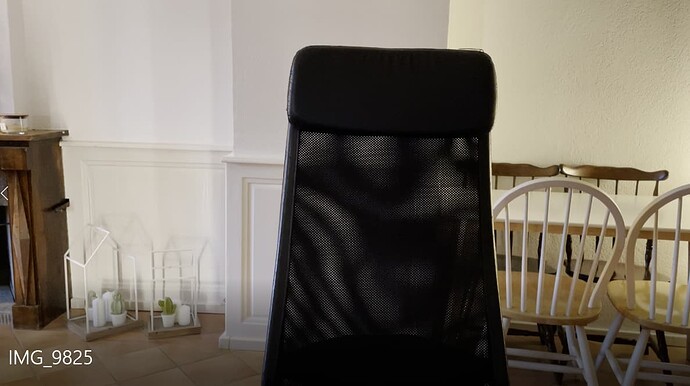

This is without Gaze Redirect
This is not an expected output, could you provide me with the command you used to process your video?
Of course !
Here is the command I use :
SETLOCAL
SET PATH=%PATH%;…..\samples\external\opencv\bin;…..\bin;
SET NVAR_MODEL_DIR=…..\bin\models
GazeRedirect.exe --offline_mode --split_screen_view=false --in=IMG_4619.mp4
I found a solution. I used HandBrake and I encoded it in H.256 !
