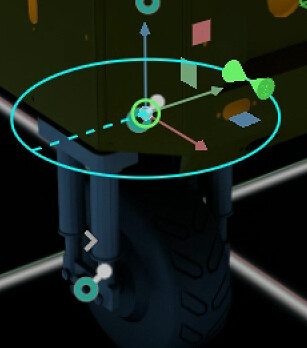

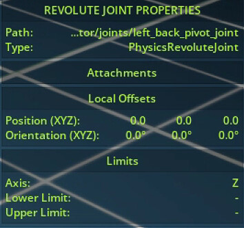

Sorry to bother you @zhengwang,Laterly I’ve encountered an issue: when I use the Articulation Controller’s position command to control the steering wheels, I noticed that in Isaac Sim, the joint rotation appears to treat clockwise as positive.
Since we usually assume counterclockwise rotation as positive, I’m not sure whether this is defined behavior in Isaac Sim, or if there might be a problem with my USD file. I’ve checked the steering joints — they are all set to rotate around the Z-axis, and the Y-axis directions follow the right-hand rule as expected.
I would appreciate any clarification or suggestions you could provide.
@revesreveilles could you please share your USD file? The direction of the Z-axis also matters.
Sorry, I’m not able to share my USD file at the moment. However, I can confirm that the Z-axis orientation of the steering wheel joints is consistent with the Z-axis direction defined in Isaac Sim, as shown in the image below(the blue axis represents Z, and the red axis represents X.).
