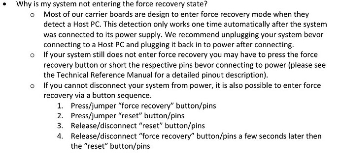

the card don’t have power or rec buton. there is only a reset button. i read the documents. it says
Ekran görüntüsü_15-7-2025_121542_auvidea.eu
7 and 8 are pin numbers. and
I tried to short circuit with a jumper. But the card didn’t to recovery mode.
For the case of a reset button I assume power is already up. You then hold down the recovery button and tap reset, then let go of the recovery button.
I don’t know about that specific carrier board, but many boards have a voltage level converter; the module operates at 1.8V, but the button and many GPIO on a dev kit carrier board are level converted to 3.3V. Any Auvidea customizations I do not know about. Like the shift key on a keyboard, that recovery key does nothing unless there is another key momentarily activated. I would question Auvidea’s instructions where one must wait a few seconds to let go of the reset button, but if the sequence is:
  1. Power on.
  2. Hold down recovery button.
  3. “Tap” the power reset button (press down, then let go with no waiting).
  4. Let go of the recovery button.
    …then I would expect it to go into recovery mode.
Recovery mode might be difficult to detect since only one of the USB connectors (one supporting device mode) works to be detected via the other Linux computer’s “lsusb” function. I don’t know what power L.E.D.s might be visible in that mode, I’ve never personally seen an Auvidea carrier board.
Incidentally, power on could be substituted for power reset. You could hold the recovery pins, add power, and then let go of the recovery pins. This too should become recovery mode.
