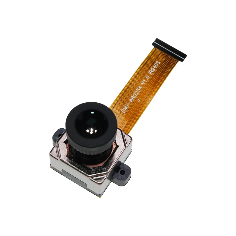

How can i use camera ar0234 on jetson nano 2gig?
I want to use camera ar0234 on jetson nano 2gig but couldn’t find compatible driver.
in this page: Install TEVI AR0234 camera driver for Jetson Nano, contain ar0234c camera, but when download and install driver, not create any folder in /dev/video*.
this is my camera information:
Looks like the driver is for Orin Nano.
For Nano you may need to modify the device tree.
https://docs.nvidia.com/jetson/archives/l4t-archived/l4t-3276/Tegra%20Linux%20Driver%20Package%20Development%20Guide/camera_sensor_prog.48.1.html#
