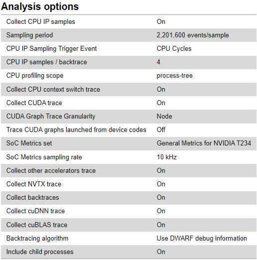

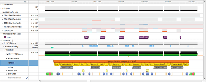

- On Jetson Host
Collect other accelerators trace
is ON

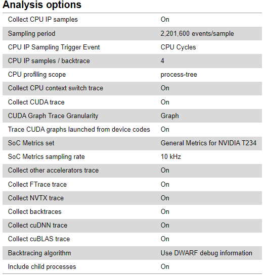

- Inside Container
is not ON
Even inside the docker SoC metrics of DLA can be obtained, so the model run successfully and use DLA also inside docker. However, I cannot obtain DLA profile (other accelerators trace
does not exist in the profile).

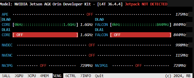

I use jtop
and it shows that DLA is turned on when a model run, so I think that DLA is supported and enabled in the container.
(I don`t know why it says “Jetpack NOT DETECTED”)

/opt/nvidia/nsight-systems/2024.5.4/bin/nsys profile --trace=cuda,nvtx,cublas,cudla,cusparse,cudnn,tegra-accelerators --accelerator-trace=tegra-accelerators --soc-metrics=true --output=model_gn.nvvp /usr/src/tensorrt/bin/trtexec --loadEngine=model_gn_container.engine --iterations=10 --idleTime=500 --duration=0 --useSpinWait
- profile results is as below:
is still not ON

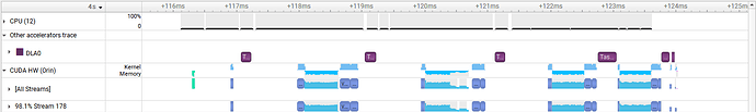

Recently I also work on old Isaac ROS Dev with JetPack 5.1, and when I happened to try the same DLA tutorial inside the container, I noticed that I could obtain DLA profile inside a Docker Container built with this old configuration.
- Configuration
- Hardware Platform : Jetson AGX Orin 32GB
- JetPack : 5.1.5
- Nsight Systems : NVIDIA Nsight Systems version 2024.5.4.116-245435654689v0
- Docker : 26.1.3
- NVIDIA Container Toolkit : 1.11.0
- Image :
nvcr.io/nvidia/isaac/ros:aarch64-ros2_humble_42f50fd45227c63eb74af1d69ddc2970
- profile results inside the container
is On
I don’t know what is the key difference between new and old configurations, but there might be a clue for a solution.

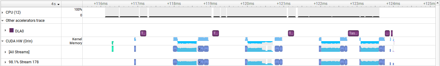

We have confirmed that the SoC metric collection can work well inside the container.
Please try if this can work on your side as well.
$ sudo docker run -it --rm --runtime nvidia -v /home/nvidia/bug_5435383:/home/nvidia/bug_5435383 nvcr.io/nvidia/tensorrt:25.06-py3-igpu
# /opt/nvidia/nsight-systems/2024.5.4/bin/nsys profile --trace=cuda,nvtx,cublas,cudla,cusparse,cudnn,tegra-accelerators --accelerator-trace=tegra-accelerators --soc-metrics=true --output=container_0815 /usr/src/tensorrt/bin/trtexec --onnx=./mnist.onnx --useDLACore=0 --allowGPUFallback --fp16
@AastaLLL Hi,
Thank you so much for your investigation and I’m sorry for a late reply. I would like to check that command in my env within this week.
I’m sorry to ask a question before checking it by myself, but I would like to ask you one thing. In the last comment, you said that you can collect SoC metric inside the container, but how about the accelerators trace?
In DLA tutorial, I can collect SoC Metrics but I can’t collect ‘other accelerator traces‘ inside the latest Isaac ROS Dev Docker (in a top comment, there are snapshots of Nsight systems outside and inside the container ( How could I get DLA profile with Nsight Systems on Jetson AGX Orin inside a Docker container ))
Could I expect to get both SoC Metrics and trace data, or only SoC Metrics by the command? In the latter case, would it be valid to use SoC metrics information instead of trace data?
Does this work on your side as well?
In the test before, we missed the --soc-metrics=true
configuration so the SoC metrics are not generated.
After adding the config, we can get the DLA information as expected.
