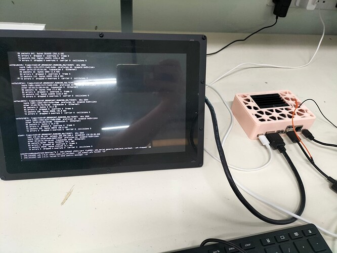

Right now when I connect to my jetson nano using HDMI I go to the command line enviroment
I did edit the node configuration file: sudo vim /usr/NX/etc/node.cfg .Following this link [https://knowledgebase.nomachine.com/AR02R01074 ] but I have change it back to defalt what should I do to change it back to a desktop enviroment.

Found the problem I needed to start the GUI

No sorry if I am not clear but some how the gui disable it self so I needed to start the gui to see the screen/deskop enviroment.
