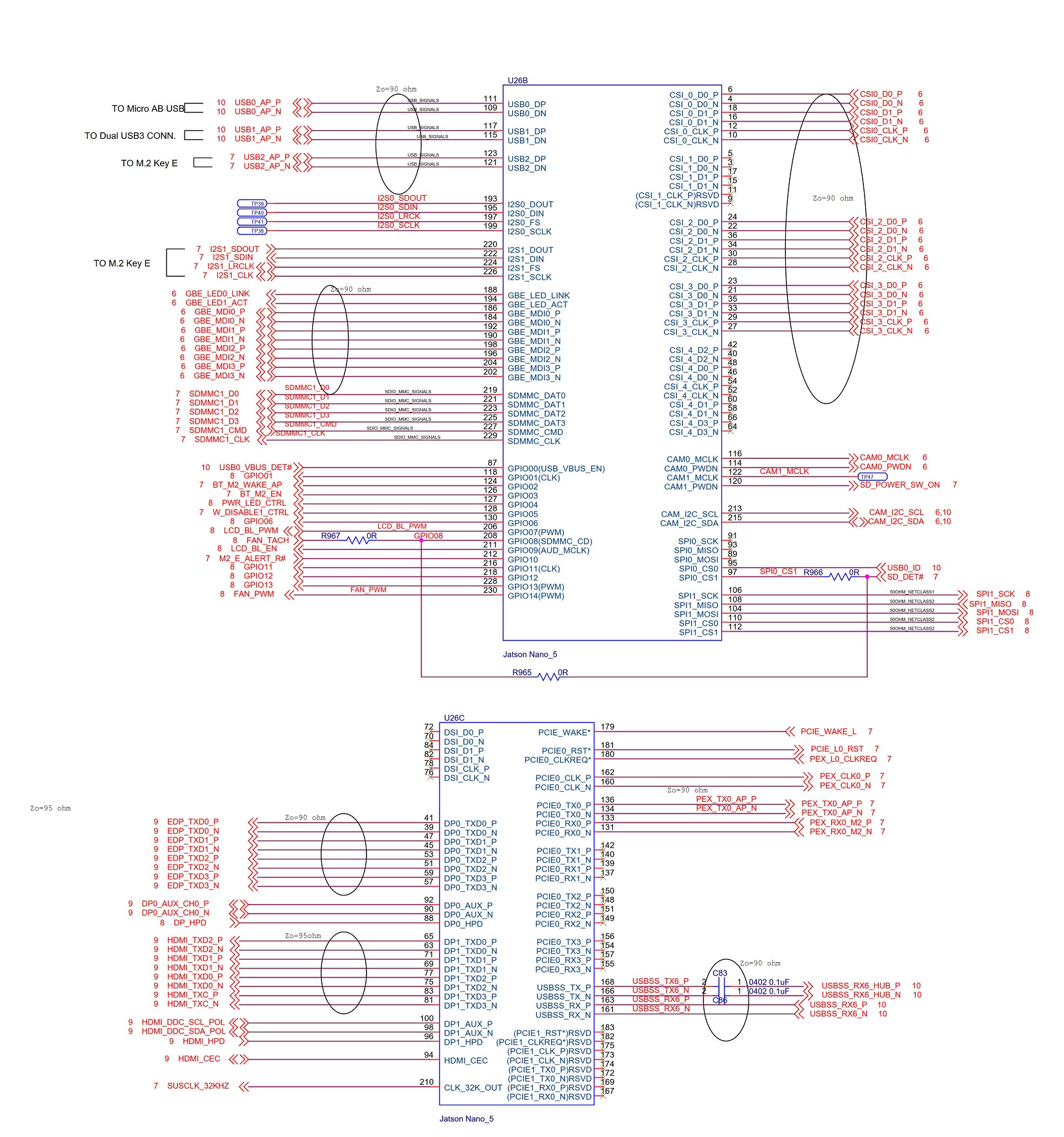

We had design carrier board with eDP for Nano (emmc).
The default HDMI (DP1) is work fine, so We would like to use eDP panel.
How to change DP0 to eDP and driver it?

Hi Karis,
DP interface is compatible with eDP. What is the problem you have here?
Could you share you hardware schematic of this part?

Hi WayneWWW,
I share our hardware schematic of edP part.
We are waiting for your confirmation.Thank you!

Hi WayneWWW,
The monitor is no backlight. PNL_BL_EN、PNL_BL_PWM pins status are not high.
We tried to control the pins through commandline,but it’s not worked.
So we moved PNL_BL_EN、PNL_BL_PWM pins to other pins and pull high, the monitor was working fine.
Do you have any advice which pins for eDP backlight we can use ?
How to control backlight ? not just brightbacklight.Thanks!

Hi Karis,
Do you mean if you connect PNL_BL_EN and PNL_BL_PWM to some GPIO and pull it high, the monitor works fine w/o any issue?
Hi WayneWWW,
Yes,we connect those pins to other GPIO pins and pull high, the monitor is bright.

Hi Karis,
Few questions here for you
For the backlight control, I think the third case is the solution here. The display driver is not able to control the backlight directly and hence it should be done through the sysfs of pwm driver.
- Yes!
- We refer OEM Design guide to design our carrier board, Did we miss something?
No, nothing is wrong. We just want to improve our OEM DG.
- What you mean? We only modify dts. Before we modify the dts,the monitor is no backlight.
I am wondering why this does not get worked. This pin should be also pwm compatible. Need to know what you’ve change in dts.

Hi Karis,
According to your previous comment, you should be able to change backlight through in case3.
When we use different value,the monitor backlight is a little change.
EX: echo 100, the backlight is dark than echo 255.
I think the only issue here is somehow the GPIO7 mentioned by design guide is not able to be a PWM pin. In your dts, the “nvidia,function” should always use lower case, so please not use “PWM0”.
You could also try to use our pinmux spreadsheet on download center to generate the correct pinmux dts.
If my understanding is not correct, please let me know your exact question.
Hi WayneWWW,
Sorry,It’s my mistake,I give you the wrong dts about gpio7.
It’s correct dts about gpio7 below,and I got dts by use pinmux spreadsheet.
lcd_bl_pwm_pv0 {
nvidia,pins = “lcd_bl_pwm_pv0”;
nvidia,function = “rsvd3”;
nvidia,pull = <TEGRA_PIN_PULL_UP>;
nvidia,tristate = <TEGRA_PIN_DISABLE>;
nvidia,enable-input = <TEGRA_PIN_DISABLE>;
I modify pinmux-config-p3450-porg.h and replace the u-boot.bin.
After flash bsp, the monitor’s backlight is bright.
So if I want to pull up the gpip, I need modify dts and uboot? Not just modify dts.
