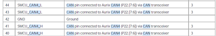

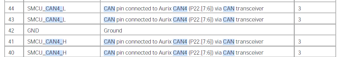

How to develop “CAN” functionality on the development board? I find some CAN interface , but i don’t know how to use and verify these interfaces.
Dear @zhaohm8,
Note only CAN0/CAN1 are supported.
Please see How to Test CAN | NVIDIA Docs if it helps.
