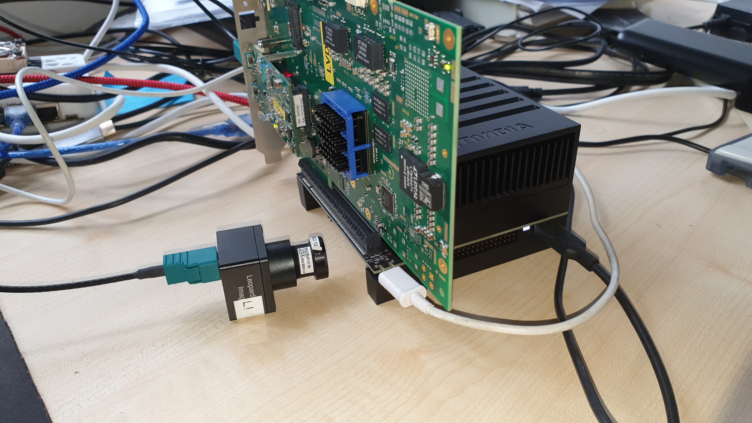

Under Ubuntu16 I dont see any /dev/ttyUSB* devices. On Windows 10 I get a COM9 under which I get a login screen to the Xavier when I use putty as a terminal. But no log or boot menu.
I guess you have something wrong in your setup. Here is a guidance for you to check.
And you can also take a photo how your board is connected.
As for what you see on windows, do you see anything printed prior to the prompt of login?
Ok I got a bit further. On Linux I see it as /dev/ttyACM0. I can again login but if I reboot the devkit the console disconnects and when I am back able to connect I see the login again.
Ahhh I indeed made a mistake here. The PC was connected to the USB-C connector. But not the Micro-USB. Let me check now.
