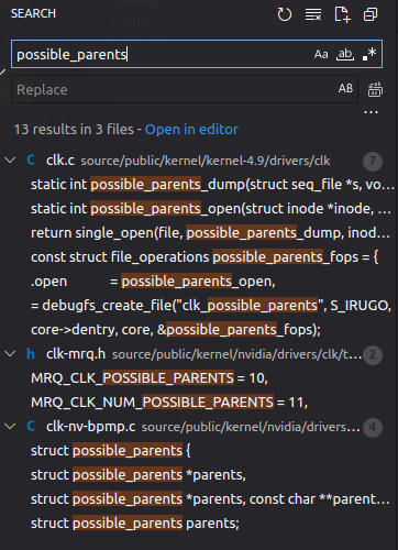

Generally there should be a “possible_parents” node inside each of client. For example, sor has such node and it can change parent clock from that list. I am not sure about DSI. If there isn’t this, then may not able to configure.
I can’t seem to find any possible_parents node anywhere on the kernel. The only thing about clocks that DSI has, is:

Yes, you cannot find it because it is in bpmp, not in kernel.
/sys/kernel/debug/bpmp
root@tx2nx:/sys/kernel/debug/bpmp/debug/clk/dsi# ls
dvfs  max_rate  min_rate  mrq_rate_locked  parent  rate  state
root@tx2nx:/sys/kernel/debug/bpmp/debug/clk/dsi# cat parent
pll_d_out1
Yeah, so it seems DSI can only work with pll_d clocks unfortunately :(
