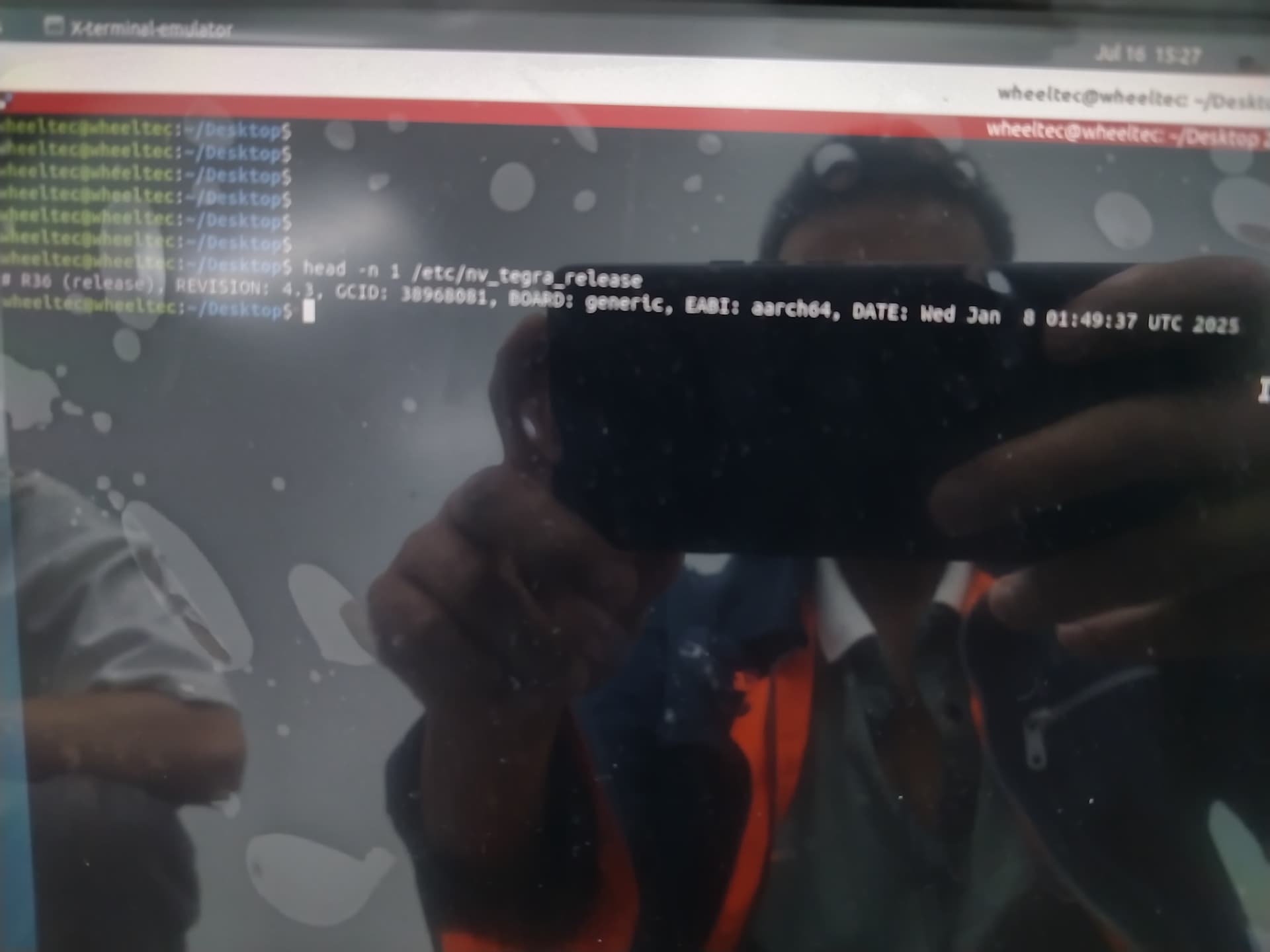

How to flash uefi_StandaloneMmJetson_RELEASE.bin ? Which platform does it correspond to?
I do not know what that file is from. If I did know, then there would still be a lot of information needed to answer. If this is an SD card model of the original Nano (without eMMC), then probably this would be some part of either a normal flash or a QSPI flash. You’d always want to back up first, but “often” content similar to this goes into the QSPI for SD card models. For an eMMC model it probably goes into one of the binary partitions. In both cases this is a flash procedure since the content is signed as it flashes.
Is the Jetson currently running? If so, what is the output from “head -n 1 /etc/nv_tegra_release”? Is this an SD card model without eMMC?
command not found
For reference, your L4T release is R36.4.3. Content which is correct for working on that release can be found at:

The PC board is as follow. I only install linux os in the PC board. Now want to flash the bios.
The linux version is as follow .Can not find nvidia_nvidia_sdk package.
For reference, this is L4T R36.4.3. This is also not a Jetson Nano, so it is in the wrong forum, but that won’t really matter. The hardware is an NVIDIA Jetson Orin NX according to the screenshot.

The storage is SSD. and how to update bios in the platform. The orin motherboard was purchased officially
Just a reminder, this is not the Orin forum. Assuming from screenshots that this is an Orin NX, then the correct forum is here:
https://forums.developer.nvidia.com/c/robotics-edge-computing/jetson-embedded-systems/jetson-orin-nx/487
(instructions change quite a bit depending on model; the plain “nano” is around a decade old and is a small form factor TX1; since then there has been TX2, Xavier, Orin, and recently Thor)
Any flash to a non-default storage media uses the “initrd” flash. This is a full flash, and covers the equivalent of a BIOS (there is no simple hardware BIOS). If you need to save content then you should first clone the rootfs partition (this contains the operating system). If you don’t need to save the rootfs partition, just use the initrd flash.
From your screenshot it shows L4T R36.x (more specifically, it shows R36.4.3). The previously mentioned URL is where you get the flash software, and when installing via JetPack/SDK Manager, this also installs the initrd flash content:
