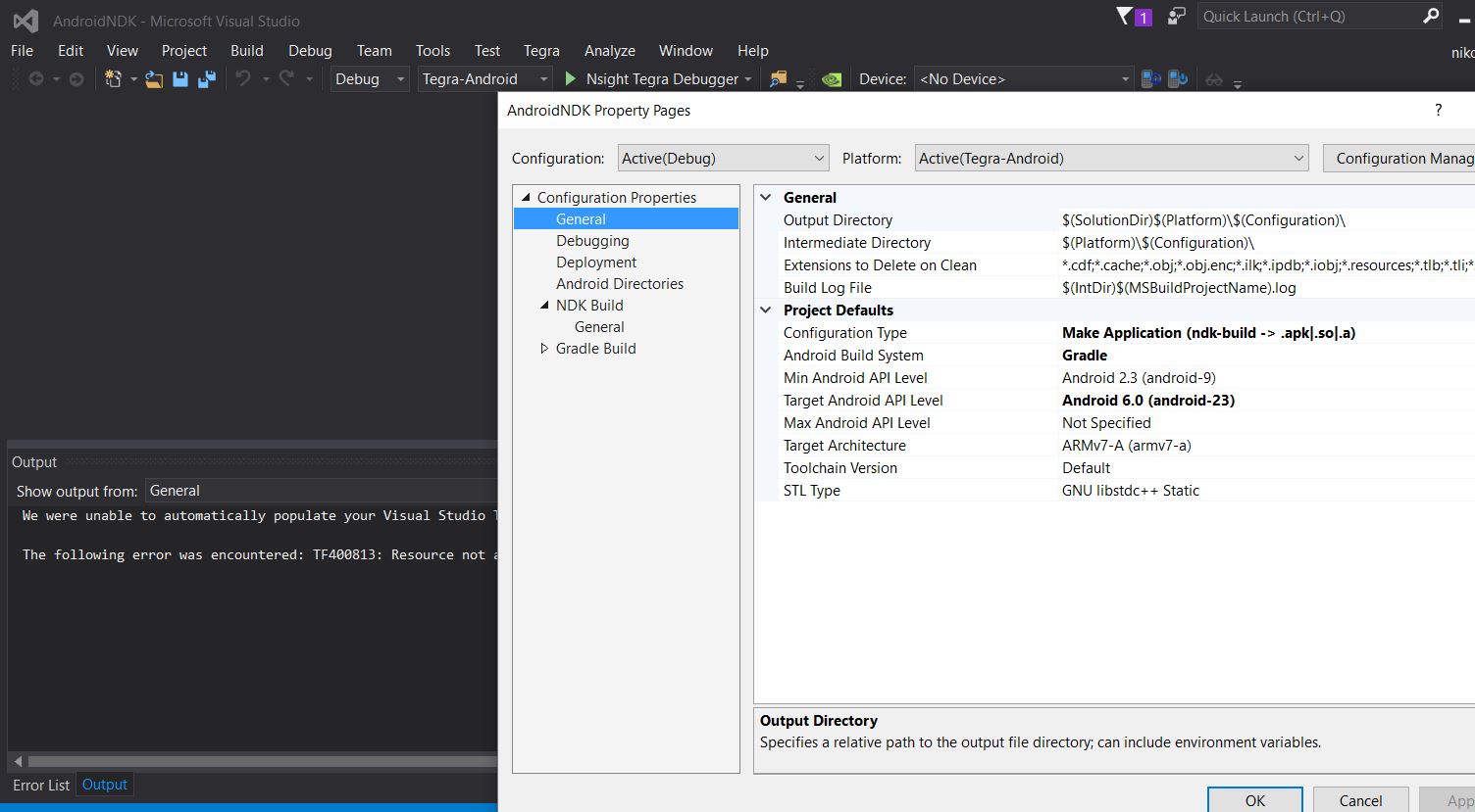

Sorry, but I can’t find this path. Please see my Project’s properties tabs.
and second question: am I right that I don’t have to explicitly indicate any paths for locations of c/c++ sources and .so libraries if these files are already were placed within directory with code, I have imported my project from?

from your the picture, You don’t use template Import an ndk-build Android Project
What I said is for this kind of projects.
If you just use a normal Nsight Tegra project, which uses MSBuild instead of make, there is no need to set *.mk.
Victor

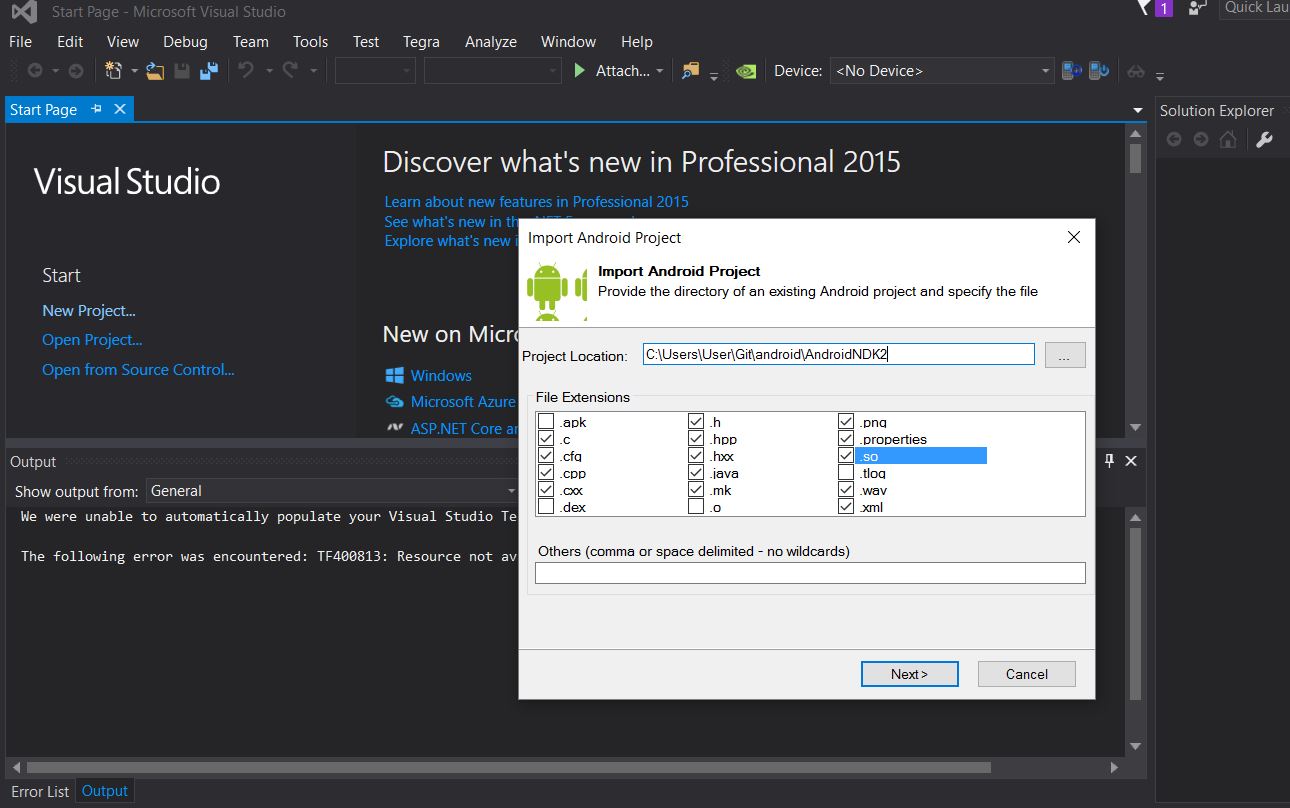

Hi, as I understand I cannot change template of existing project, right?
So I created / imported new android NDK project from existing sources
Now I get the following error: “ndk-build.cmd” exited with code 2

You can use set Android Build system via Project Properties>Configuration Properties>General>Project Defaults>Android Build System.
what is the difference of using MSBuild vs. make?
Night Tegra adapt MSBuild to native code build, MSBuild has good integration with VS IDE, you can change build options at Project Properties.
Android NDK use make as it’s default build system.
They are two independent build system.
What should I changed in project to use that?
You can see the change native build system at Project Properties>Configuration Properties>General>Project Defaults>Configuration Type:
NDK-Build: use make (NDK default way)
External Build: user defined way
Others: Night Tegra’s own build system based on MSBuild.
Remove Android.mk file and МЫ will build all automatically using just Gradle scripts?
There is no magic water, all depends on your configuration. there is no need to Remove android.mk.

It looks that the NdkProjectPath is not correct, but I am sure I indicated a full absolute path to the directory where Android.mk is located (see screenshot).
C:\Users\User\Git\android\androidNDK\app\src\main\cpp
What is wrong?

From your project file and *.mk file, The migrating project is large and has its own some customization building steps.
The better way is to use External build system with it’s existed build system, not to create the Nsight Tegra MSBuild config for each lib and sub-project.
You can add External build system config, write dos batch file to trigger its own build system and then add dos batch file to Build and Rebuild cmd line at Configuration properties>NMake Page.
You can use Nsight Tegra for debugging by set the Configuration Properties>Debugging.
  1. Override APK path
    2 Additional C/C++ source directories
  2. Additional library symbols Directories.
victor
How can I indicate customized build script path (where Android.mk is located) and path to Application.mk with Nsight Tegra VS edition?
You can use VS MACRO such as $(SolutionDir) where *.sln is in.
