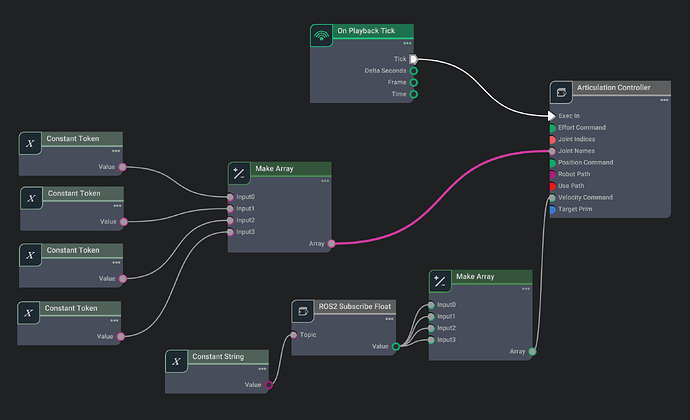

Hi, I have no problem importing the std_msg library in Isaac Sim. The problem I’m facing is how do I incorporate a ROS subscriber in it.
I have a robot that has a different driving dynamics. Hence the action graph provided by this tutorial is not suitable anymore 7.2.2. Driving TurtleBot via ROS2 messages — Omniverse IsaacSim latest documentation. I need to be able to control each wheel individually hence I need to subscribe to a float message, which is the speed of the wheel.
I tried to create my own node based of this tutorial Part Three: Create Your Own Nodes — Omniverse Extensions latest documentation
This is how my node graph looks like
This is the code of my custom node

There is no error message but it is not driving the robot.
@lee43 , in the code you have pasted above, you are creating a subscriber to the Float32 message but this is not being used to set the joint velocities for your robot (these need to be passed into the articulation controller for the robot which will then be responsible for driving it). This snippet here provides a sample for doing so. This will have to be integrated with your ROS 2 subscriber. All the best!
