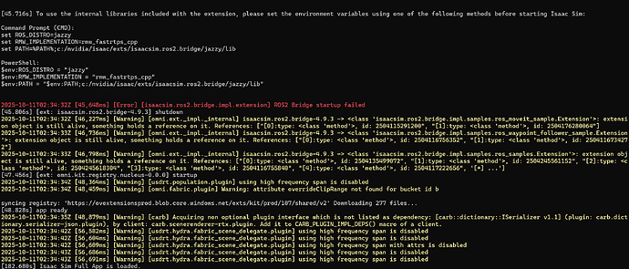

Hello i am new to isaac sim and ros2 , i want to connect my ros2 with isaac sim via ros2 bridge but my ros2 is installed in wsl2 and isaac sim in windows , i am using ros2 jazzy jalisco and isaac sim 5.0 but still no luck , even when i try to enable the ros2 bridge i get this error kindly let me know for any solution.

@VickNV ISAAC SIM is loading fine but the issue is i am using jazzy jalisco and the environment variables
$env:ROS_DISTRO = “jazzy”
$env:RMW_IMPLEMENTATION = “rmw_fastrtps_cpp”
$env:PATH = “$env:PATH;c:/nvidia/isaac/exts/isaacsim.ros2.bridge/jazzy/lib”
asked to set here the directory dosen’t exsits for windows there is no lib folder present for jazzy
for ros2 humble its preset but not for jazzy jalisco
Could you please specify which step in the ROS 2 Installation — Isaac Sim Documentation you’re having trouble with?
Also, keep in mind that the path may vary depending on your installation location, as described in the Workstation Installation — Isaac Sim Documentation.
If you can provide more details about the error or missing directory, it will help in troubleshooting your issue.
