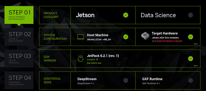

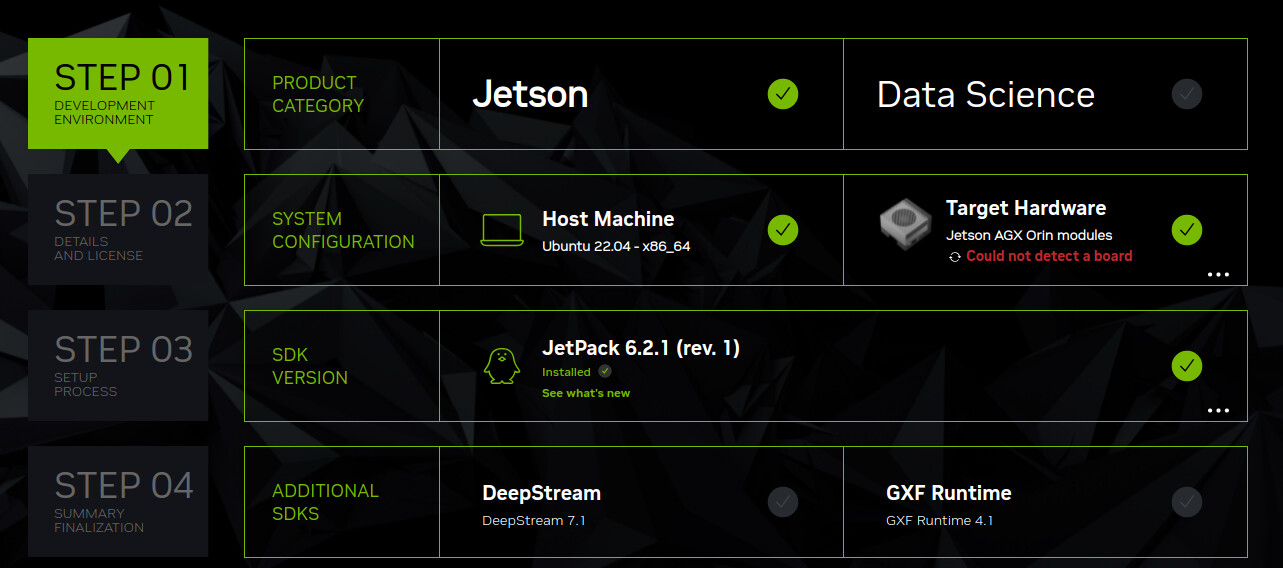

The file jetson-agx-orin-devkit.conf does not exist. Just changing the other you mentioned works?
What’s the board config you used to flash the board?

After this used SDK manager to flash the device.
Tested to change pin 40 state of the 40 pin connector and it does not work.
