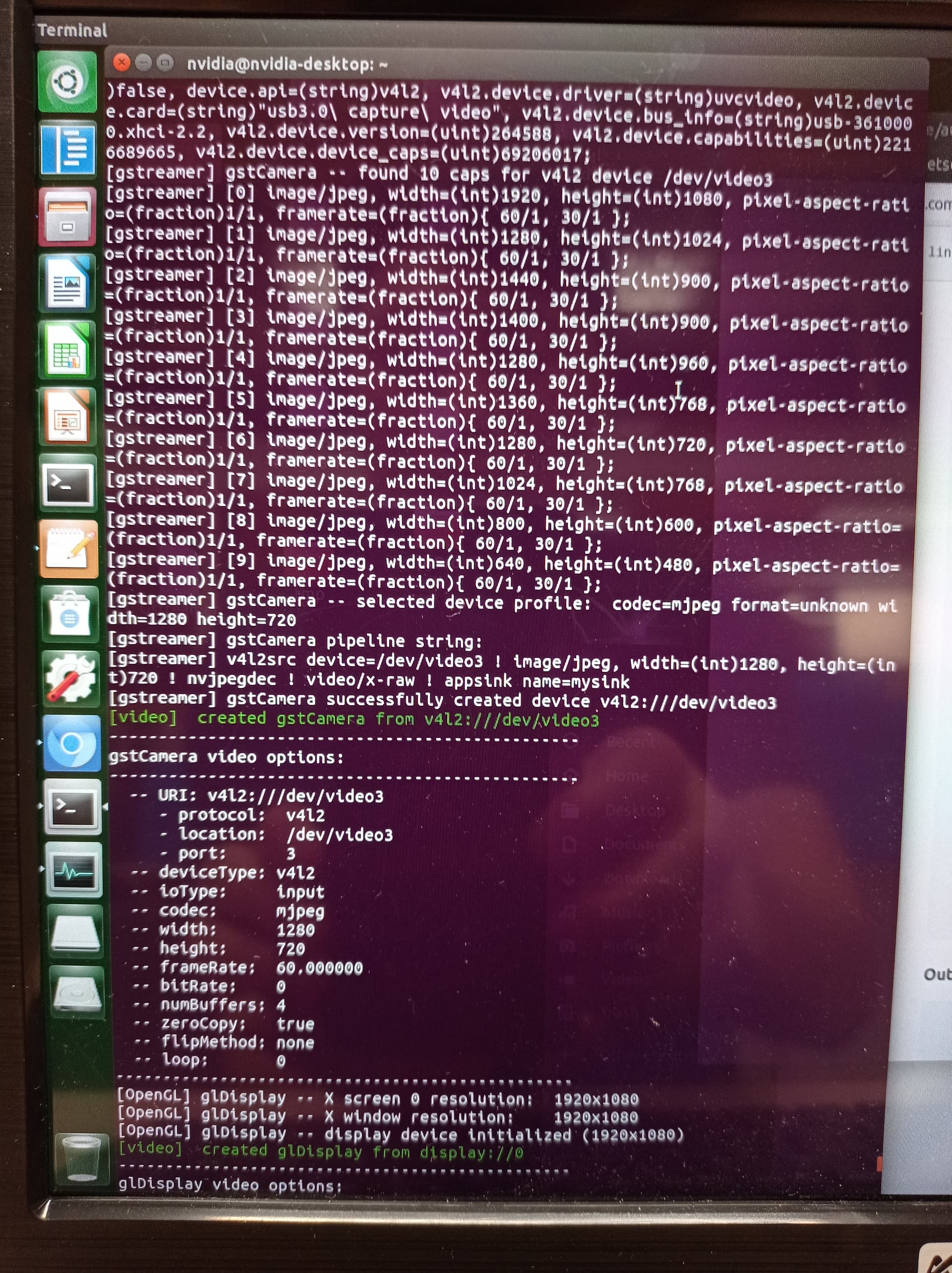

Here is the info of the USB capturing device. it use MJPEG, and I have tried --input-codec=mjpeg with --input-width=640 – input-height=480 and others, no help though…
Here are the capture screen when I run detectnet.

By default it supports USB cameras outputting YUV422 format, such as UYVY, YUYV. If your camera supports only MJPEG, you would need to customize the sample app. Please try to run the camera in gst-launch-1.0 command, and then apply the same pipeline to the sample app.

Hi @AK51, if you run video-viewer /dev/video3 do you see any video?
Are you able to view the stream with other V4L2 viewer tools like cheese, gst-launch, ect?
Also from your terminal output, it appears you are using an older version of jetson-inference - can you try cloning the latest from the repo and rebuilding/reinstalling it?
If you’re not able to see the camera feed with any tool, please provide the output of:
# -d3 will report about device node /dev/video3
v4l2-ctl -d3 --list-formats-all
so that you can first try to set up a valid gstreamer pipeline to decoded video with gst-launch-1.0.
Once you will have this working, then patching jetson-utils/gstCamera for your case may be easy.
